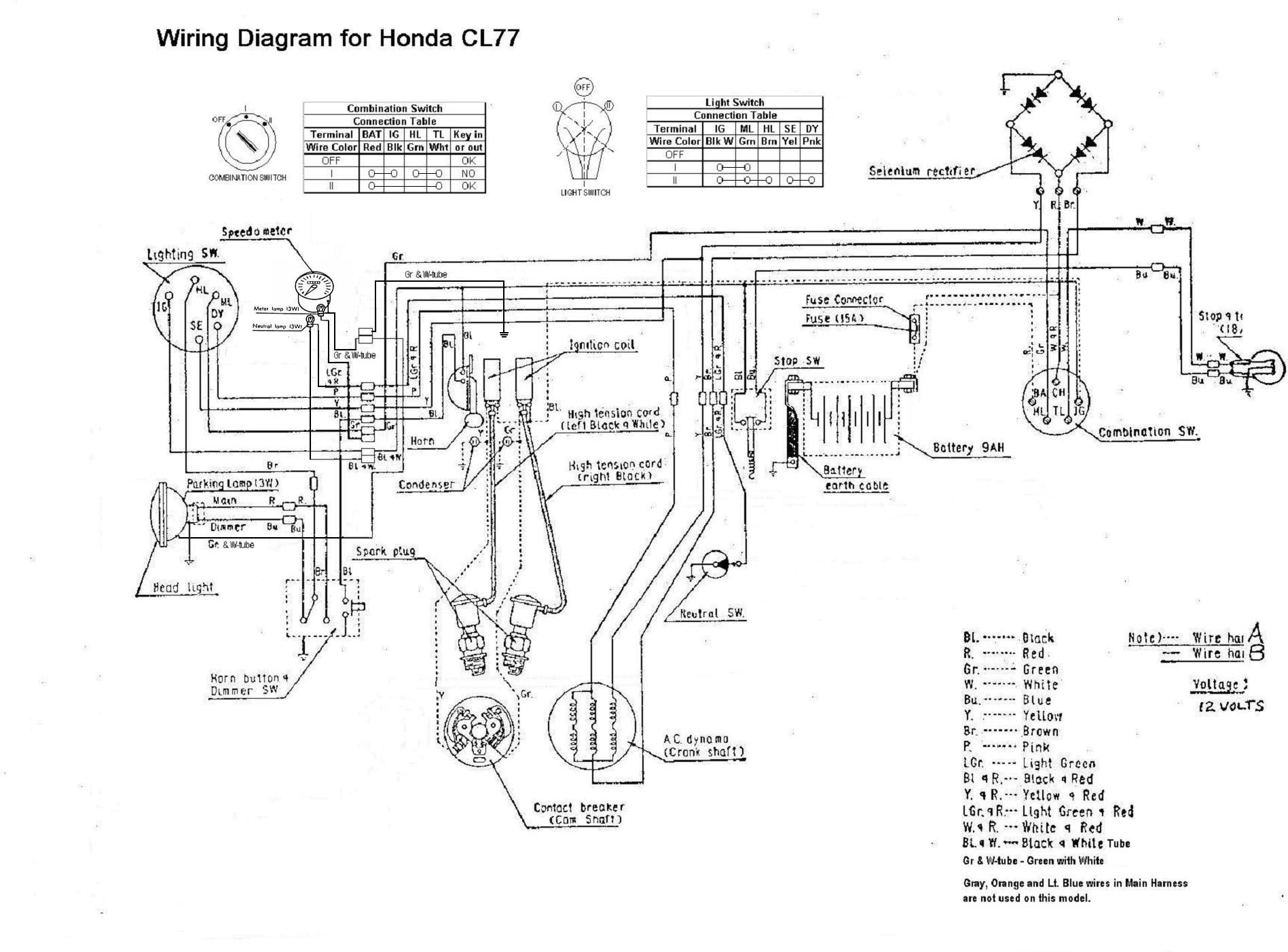

Attached is what I believe to be an accurate CL77 Wiring diagram. This is based on the CB77 wiring diagram that LM said to use when working on a CL77. I've traced all the wires on the CB77 diagram and confirmed the similarities and noted the differences. So this diagram is based on my stock 1967 CL77.
A few notes regarding my findings/observations:
1. There are three wires in the main harness that are not used. The wire colors are Orange, Gray and Light Blue. They all have female connectors on them and are run up and into the headlight housing.
2. The ground wire for the Speedo light is not grounded at the speedo. There are two green wires coming off the lamp, one has a white tube on it. There are also two green wires in the main harness and one has a white tube on it. The green wire with the white tube is the ground. The actual ground terminal for the main harness wire is one of the mounting bolts for the coil bracket. The green wire with the white tube from the main harness has a duplex female connector and to it attaches the ground wire from the speedo light and the ground wire from the headlight. All are green wire with a white tube near the connectors.
3. I believe there is an error on the CB77 diagram. The brown wire coming from the HL terminal on the Light Switch is connected to the high/low beam switch on the handlebar switch. This provides power to either the high or low beam via the HiLo beam switch. The diagram shows a green wire running from the duplex connector on the main harness which connects to the green wire from the ML terminal on the on the Light switch. The green wire on the main harness provides power to the ML terminal on the light switch. The green wire running between the harness connector and the brown wire on the diagram would be another source of power to the HiLo beam switch if it were actually there. It is NOT THERE on my CL77 and I believe it is not there on any bike or either position of the light switch would turn on the head light instead of just the II position turning on the head light. So, this green wire has been eliminated on the attached diagram. I've redrawn the wiring for this portion and have shown the ground connection near the coils for clarity purposes.
For quick reference, I've created switch position diagrams and tables for both the combination and light switches and included them on the wiring diagram.
I have also elimated any devices that are not on the CL77 US spec bike for 1967 such as electric starter, starter solenoid, parking lamp and the speedo/tach and their associated wiring.
So, if all the CL77 bikes are wired the same, this diagram should work for all of them, at least the US spec models.
If anyone thinks I made an error, please let me know and I'll confirm it with my bike and make a correction if necessary.
regards,
Rob
regards,
Rob

Thanks alot just used your diagram today to finish up my late model 66 CL77.
It was right on the money.
Thanks again
Thanks again

305 wiring
Stupid me- forgot the old right click button.
Thanks so much.
My scrambler is just about done - when I try to hook up the headlight - every time I turn on the switch on the headlight - it blows a fuse.
if I disconnect the green double wire - that is grounded to the bracket - the fuse will not blow - but the headlight will not work.
Thanks so much.
- FluteTears
- Posts: 251
- Joined: Sun Jul 01, 2007 10:15 am
- Location: Denton, Texas
Re: 305 wiring
Sounds like the hot wire to your head light is sorted to ground and not doing so at the head light.twindgg wrote:Stupid me- forgot the old right click button.
Thanks so much.
The switch can do that.
