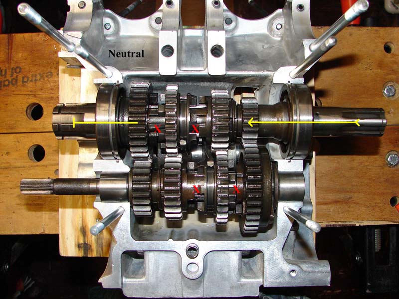

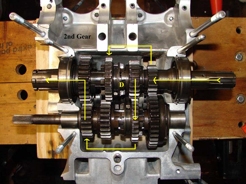

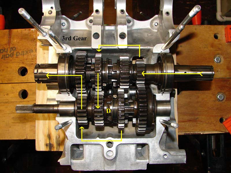

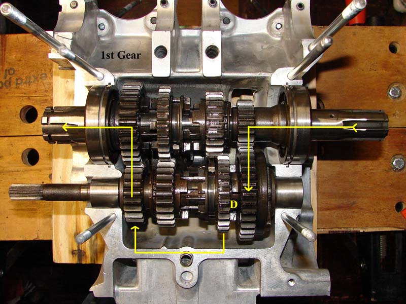

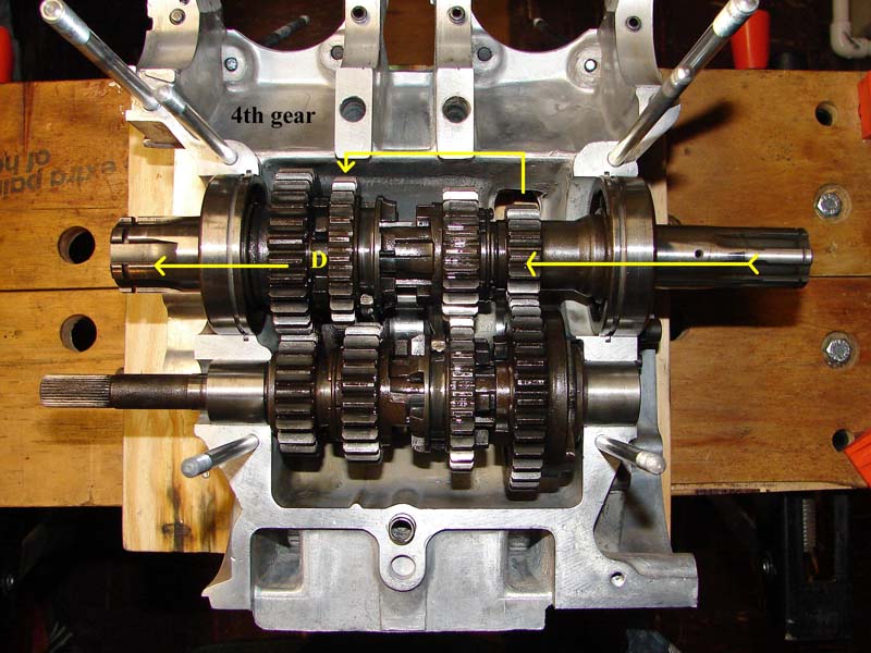

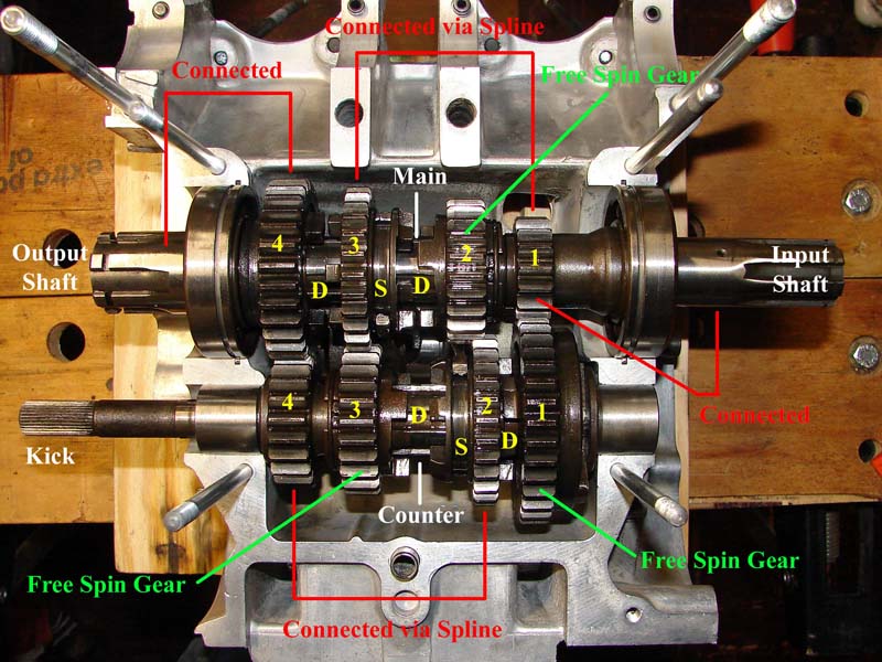

Before I got into refreshing my motor/transmission this winter I had looked thru a number of the postings here showing pictures and drawings of the transmission but I never really got a handle on just how the power was routed thru the gears. Now that I got into my transmission and see whats connected to what it finally makes sense. Just in case there are other newbies out there I thought I'd post the photos of the power train for the various gears.
George
P.S. 4th gear is in the next posting
George
