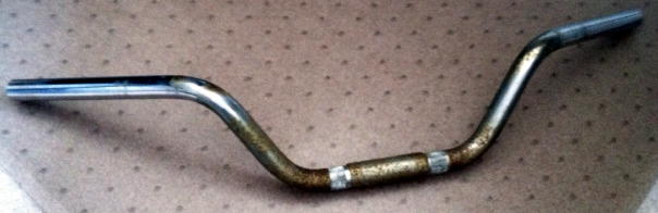

I'm trying to replace the bars that came on the bike but I don't know if they're stock or not. While lying upside down, the following measurements are:
length end-to-end, as the crow flies: 28.0"
length end-to-end, taking the long route: ~35"
rise from floor to center of bar at highest point: 5-1.4"
knurl length: 4-3/4"
O.D. at bar end: 7/8"
center reinforced piece: 3-1/16"
center cutout length: 1-1/8"
Is this the stock hi-rise bar?
Gracias
This is what came on the bike ... ugh

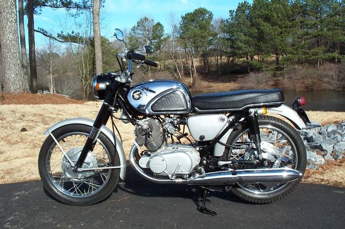

Looks like the hi-riser 'bar, Canadian CP77 aside (see pic). There was an intermediate height (see pic) between yours, there, and the more popular European flat 'bar.
Risers look 'orrible (JMHO) but provide a much more comfortable riding position.

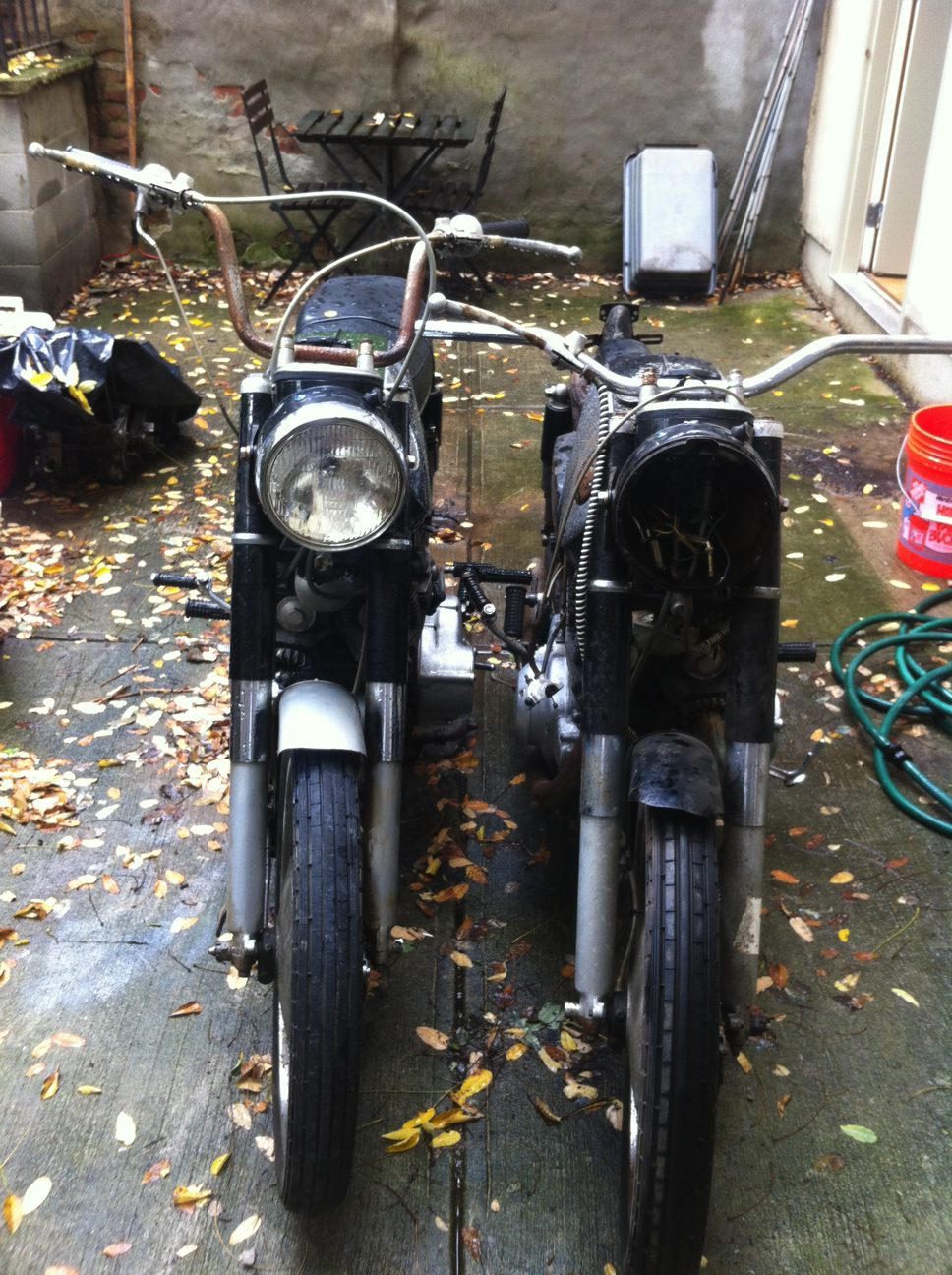

I have REALLY high bars on my bike - practically ape-hangers. Talk about unsightly- they're ridiculous. I'd planned to replace them with a flat bar from Tim McDowell.
I just bought a second '65 with the 'Serpico" bars and I think they look aces. Can those be found anywhere? I'd love to have them on both bikes.
Also- if I DO manage to find them, with the cables I bought from Tim McDowell for the flat bars still work or will they be too short? Doesn't seem like that much of a difference in rise but it might be enough to make the difference. Anyone know?
I like those on the right. I really don't like those on the left.

Post by davomoto » Fri Oct 05, 2012 9:27 am
Cables will be too short.
Davo
Posts: 2601
Post by e3steve » Sat Oct 06, 2012 5:58 am
As Davo states, the cables will be too short. The different handlebar heights require a fairly substantial change in control cables' lengths. Even a 50mm shortage in length will make the cable routing awkward, if not nigh-on impossible.
