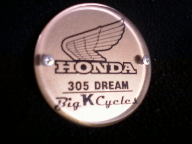

As I get closer to completion on my 65 CA77 some of the small details are starting to come
together-I wanted to show the crew here the Dream badges I had made-[img]-Please let me
know what you think....Thanx

Post by cyclon36 » Wed Mar 16, 2011 2:55 pm
Cool, how did you make that if you don't mind me asking?

Post by Hippykid » Wed Mar 16, 2011 3:51 pm
I gave my decal guy some sketches of what I wanted-He came up with a couple of designs and
I picked the one I liked-I cut some 3 inch circles out of Plexiglass ( the outer one a bit thicker
than the inner )-I angled my drill press to a 45 degree angle and sanded the edges with a drum sander chucked in...a little fine sanding along the edges...stick the decal to the inside one and cover with the thicker one-very minimal clear silicone at the seam and there you go....

Post by geosar » Wed Mar 16, 2011 5:07 pm
Very nice. And a great idea.
