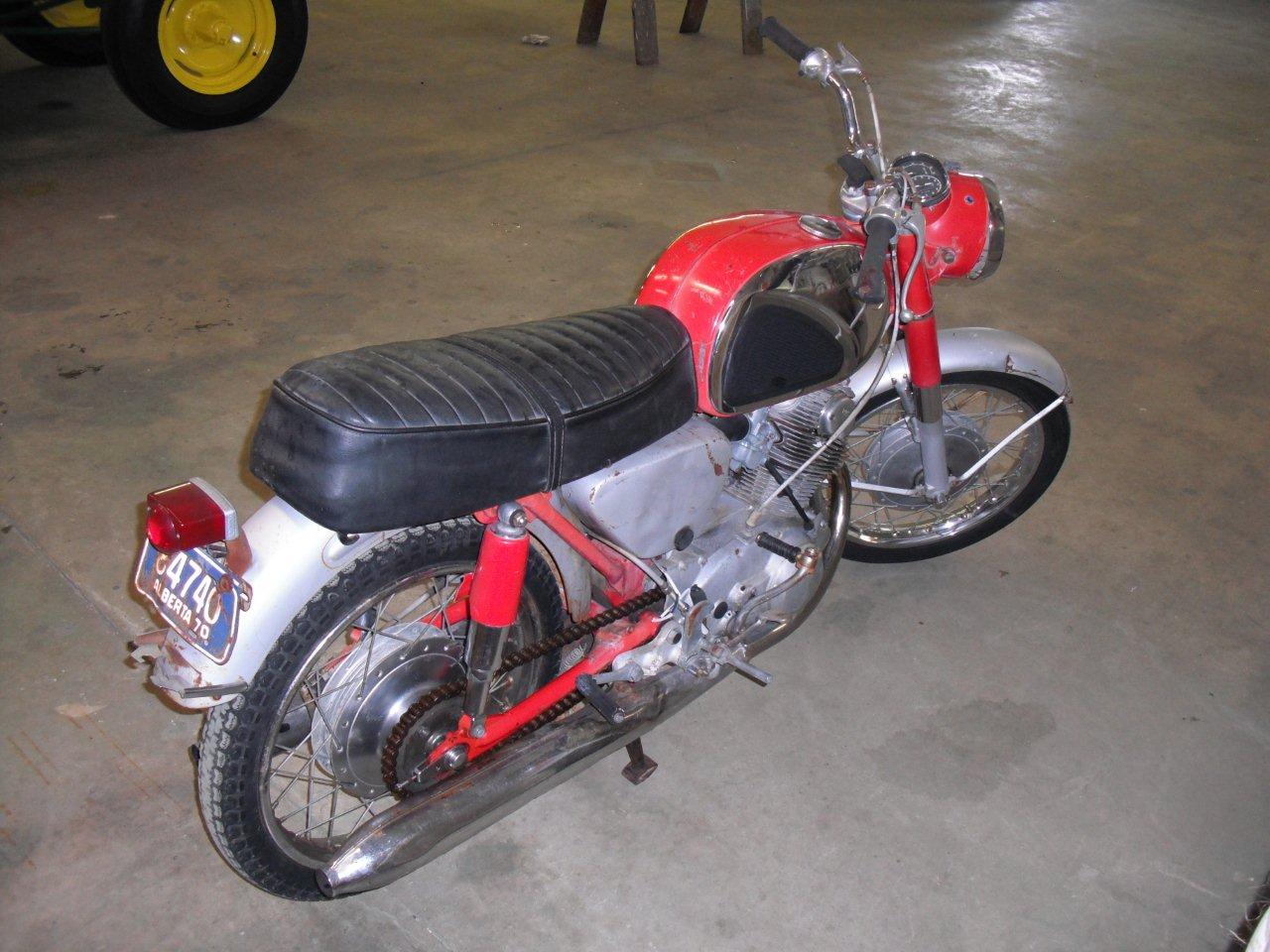

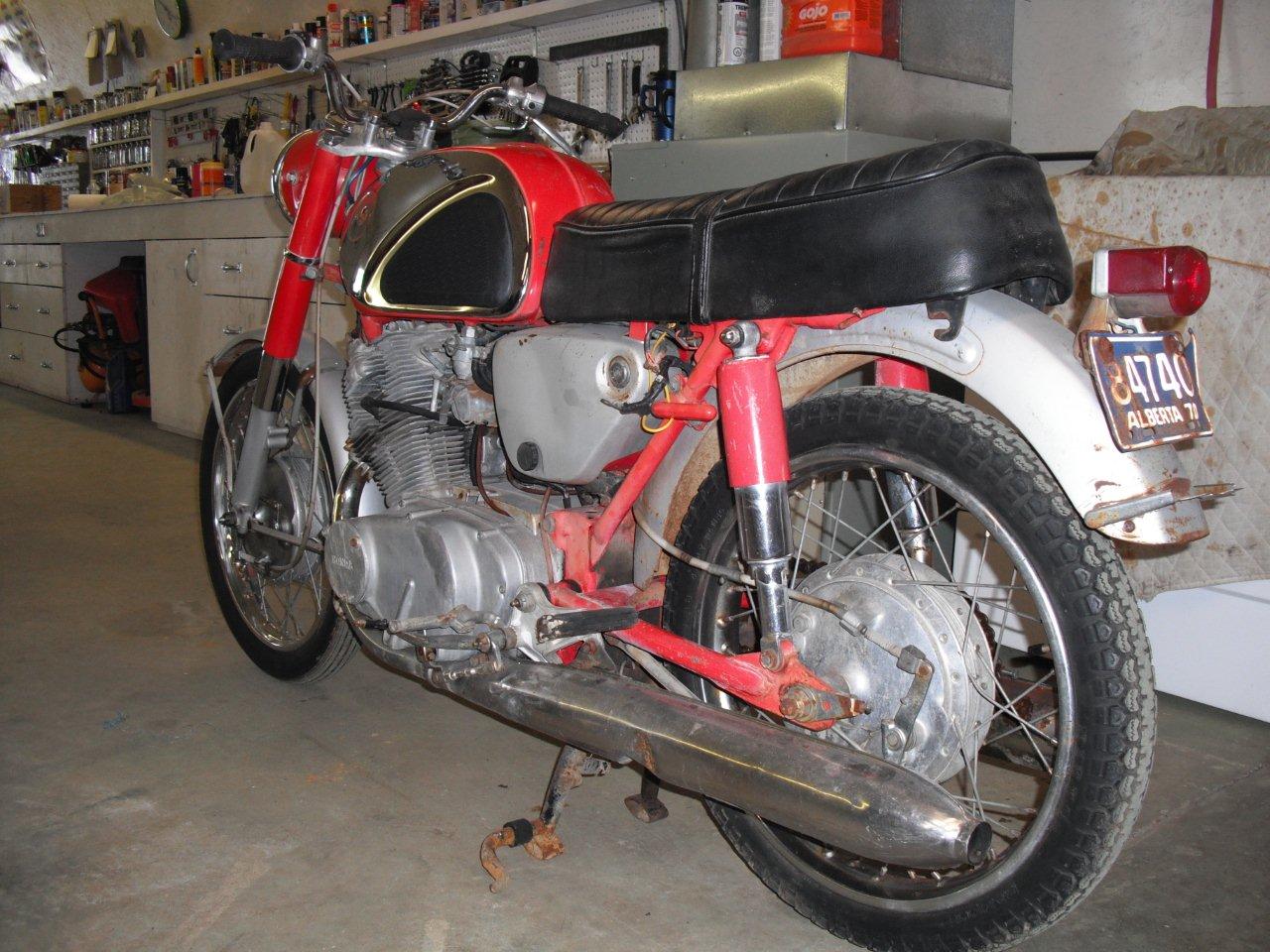

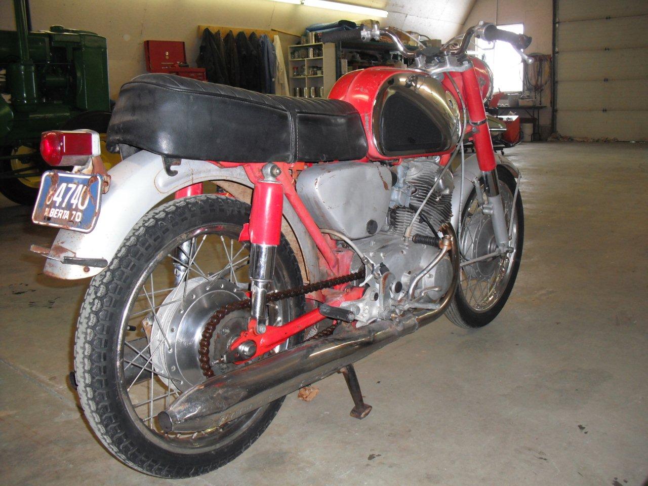

Well I finally have my superhawk and am ready to get started tearing her down. I have ordered the Bill Silvers manuals and a Honda service manual as well. My frame/engine numbers are
CB77 1044648 and CB77E 1044673. Does anyone know the actual year of this bike? I was told it was a '64. The motor isn't seized as I am able to turn it over with the kick start, although when I push it while in 4th gear there seems to be a clunk in the tranny somewhere:(
Pretty well everything is there except the chain guard and tank badges.
I have enjoyed this forum so far and will surely be asking lots of questions.
Away we go!!

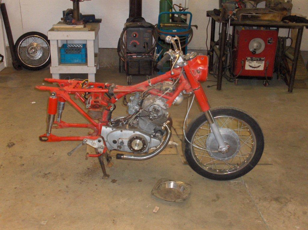

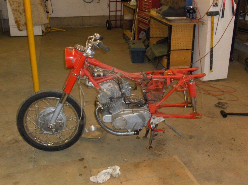

Post by clhiller » Mon Apr 04, 2011 7:53 pm
Finally got some time to get out in the shed. Don't have my manuals yet but started tearing stuff off. Everything looks in decent condition except the mufflers. I think the tranny will need some TLC as well. A total teardown is coming up!
