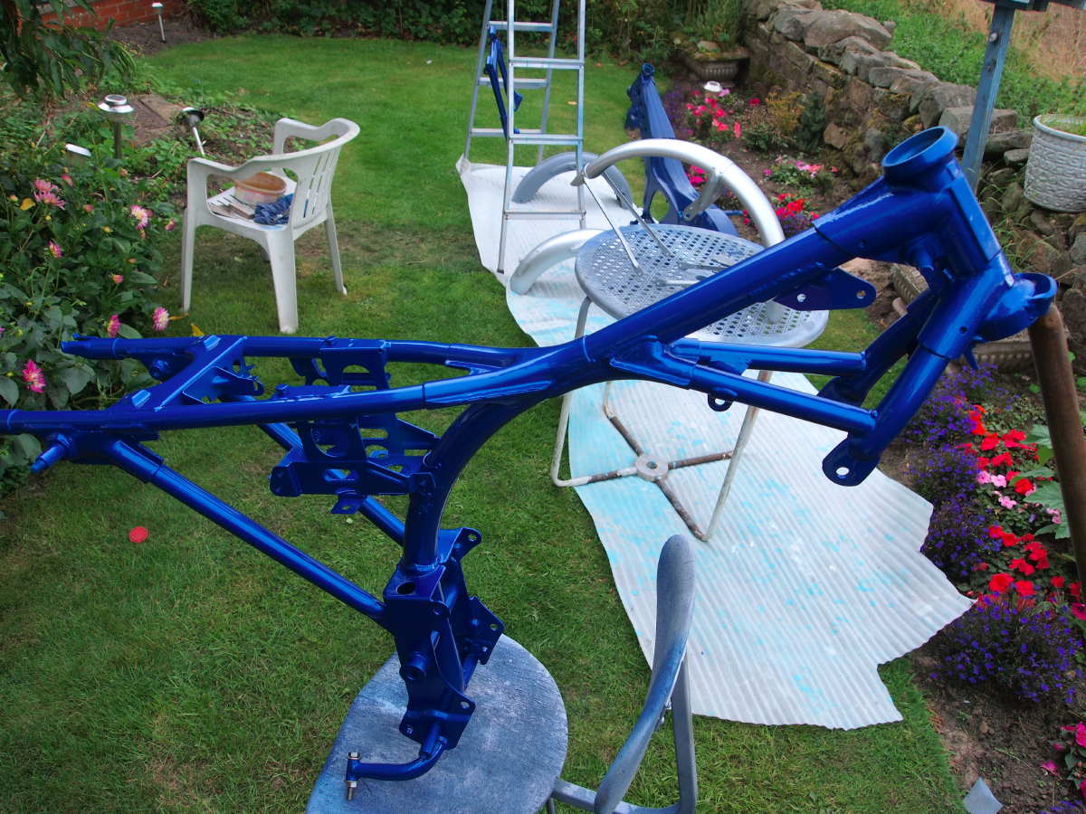

My CB77 is going to be Rover Trophy blue. I love that colour.
