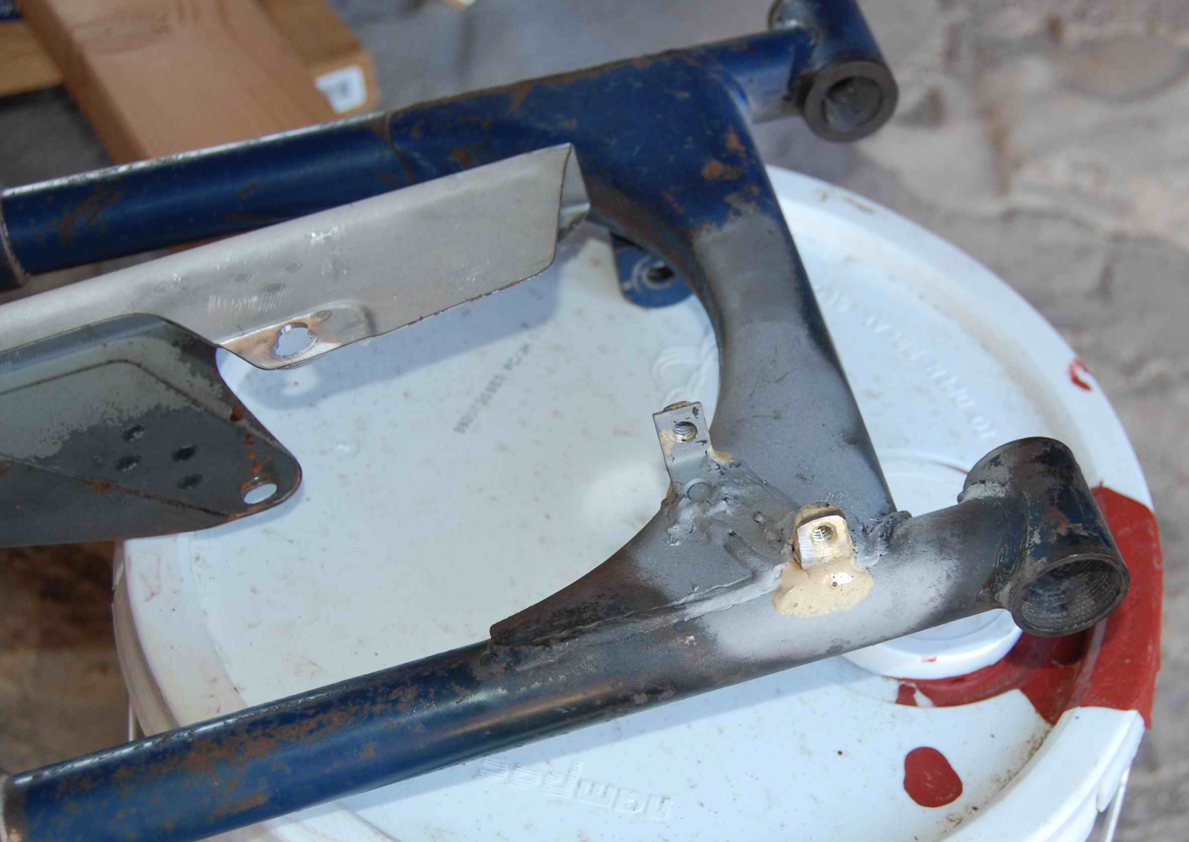

The swingarm mount for the chain guard is missing from my '67 CB77. Anyone have their guard off that could post up a pic of what the mount looks like? I'm going to see about getting one welded on.

Hi Burvis,
Here's a decent shot:
http://cgi.ebay.com/ebaymotors/Swing-Ar ... 3a65670c14
Same thing happened to me but I bought a used one instead of welding ... felt lazy that day.
The tabs are 20mm wide x 15mm high x 2mm thick with a 6x1.0 mm nut welded on to the left side of each tab's bolt hole. The nuts have an oval doubler welded to the tab as well. The holes (C/L) are 8.5mm up from the deck of the tab base. The tabs are spaced 40mm apart (inner to inner). I can't give the angled offset because my right side tab is gone.

- jleewebb
- Posts: 472
- Location: travis county, tx
chainguard bracket
This what you're looking for? Excellent work as usual by LM...
