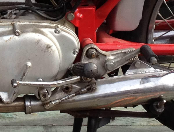

I would like to use the rearmost placement of the footpegs and remove the passenger footpegs. It appears that all I have to do is replace the gearshift rod with a longer one.
Anyone with experience?

here is a photo of the aluminum mounting poit with the three choices.
Post by davomoto » Tue Jan 15, 2013 10:48 am
Yes, a longer rod is required. I made mine from a steel rod, 1/4 inch, threaded both ends, and used rod ends to attach on both ends.
Davo

Post by rrietman » Tue Jan 15, 2013 11:06 am
I have my cb72 set up like that. It's a pretty extreme riding position. A CT-90 cylinder head stud is the right length/size/threaded ends for the extended shift rod. the stock shift rod ends (the ones with right hand threads) will fit right on.
Good luck

Post by Jlovvorn » Wed Jan 16, 2013 7:16 pm
Randy, are you saying the stud will bolt right on?
I thought the threads were backwards on the shift rod.
