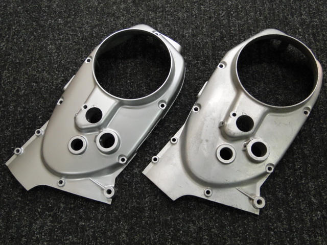

the title says it all i need to find that paint, also it looks like the same color on horn,
any ideas? thanks

I like VHT SP127 Universal Aluminum. It's an excellent match and is fuel resistant after it's baked on for 20 minutes or so; just follow the instructions on the can. Pic on right is NOS, left is SP127.
