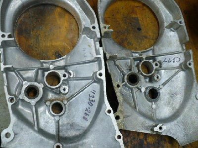

John,
Depending on which cover you use you will need to use the matching clutch wire joint. The early joint 22875-268-000 is perpendicular to the cover and the later joint 22875-259-020 is a bit angled. The later covers in addition to beefing up the casting to prevent fractures also moved the location of the cable forward a little. I'll post pictures.

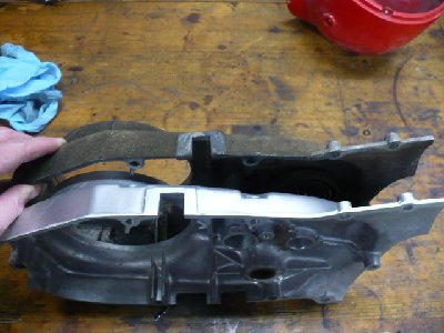

Post by John Kat » Fri Mar 08, 2013 8:09 am
Here's the picture of my ( broken) side case.
I was lucky to find a replacement on ebay!
