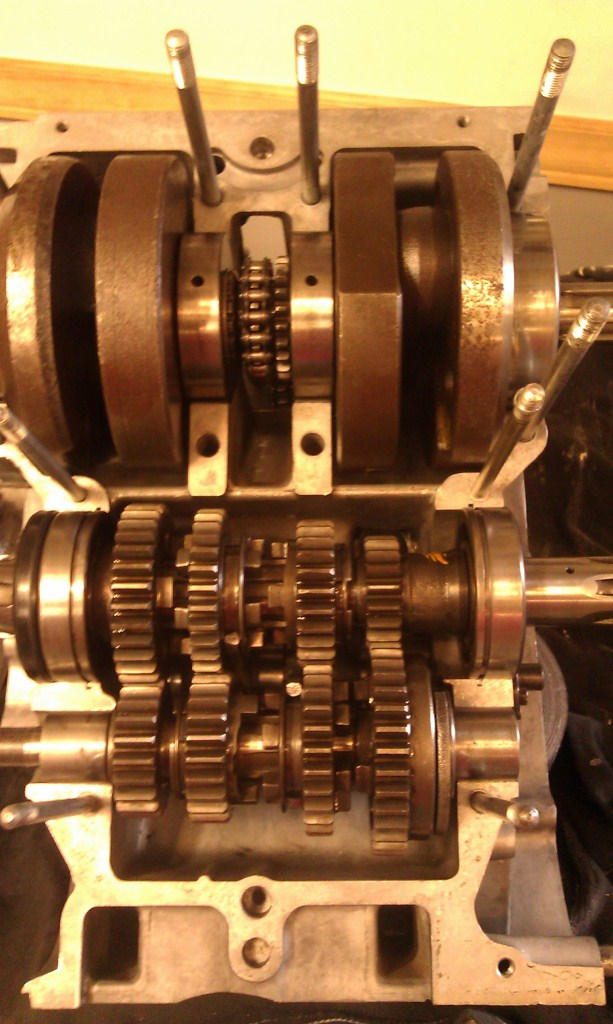

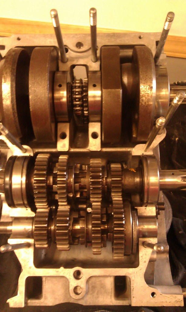

Does the crank and tranny look to be installed correctly? I just want to make sure the shift forks are installed correctly more than anything---is there any secrets I am missing?

everything looks good from the pic just make sure all pins and rings are aligned for all bearings before clamping down. They are on the crank and both tranny shaft bearings

jsmith1107 wrote: I just want to make sure the shift forks are installed correctly more than anything--
Thanks
Run it through the gears before you seal it up. I also dry test fit the bottom case half just for piece of mind. Makes it a lot easier if you have something not lined up you don't have sealer everywhere. Lastly, don't force it. I also recheck the shifting after it's together.
