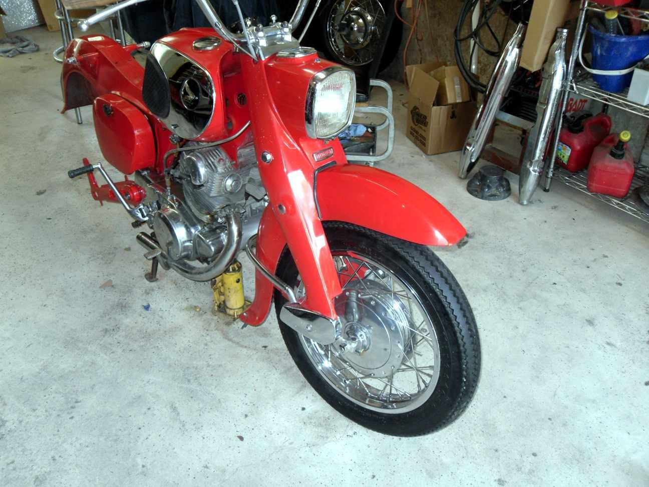

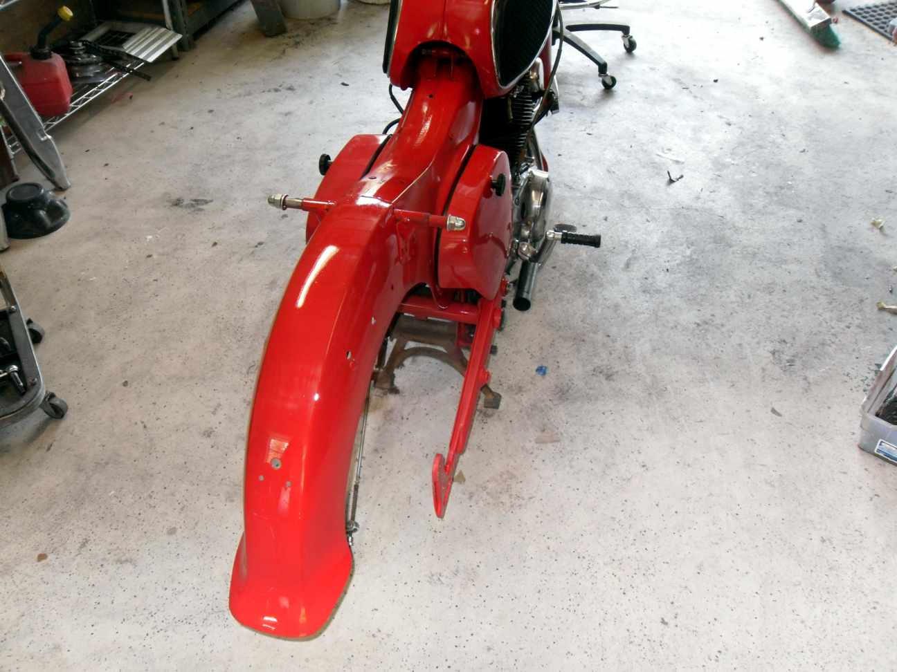

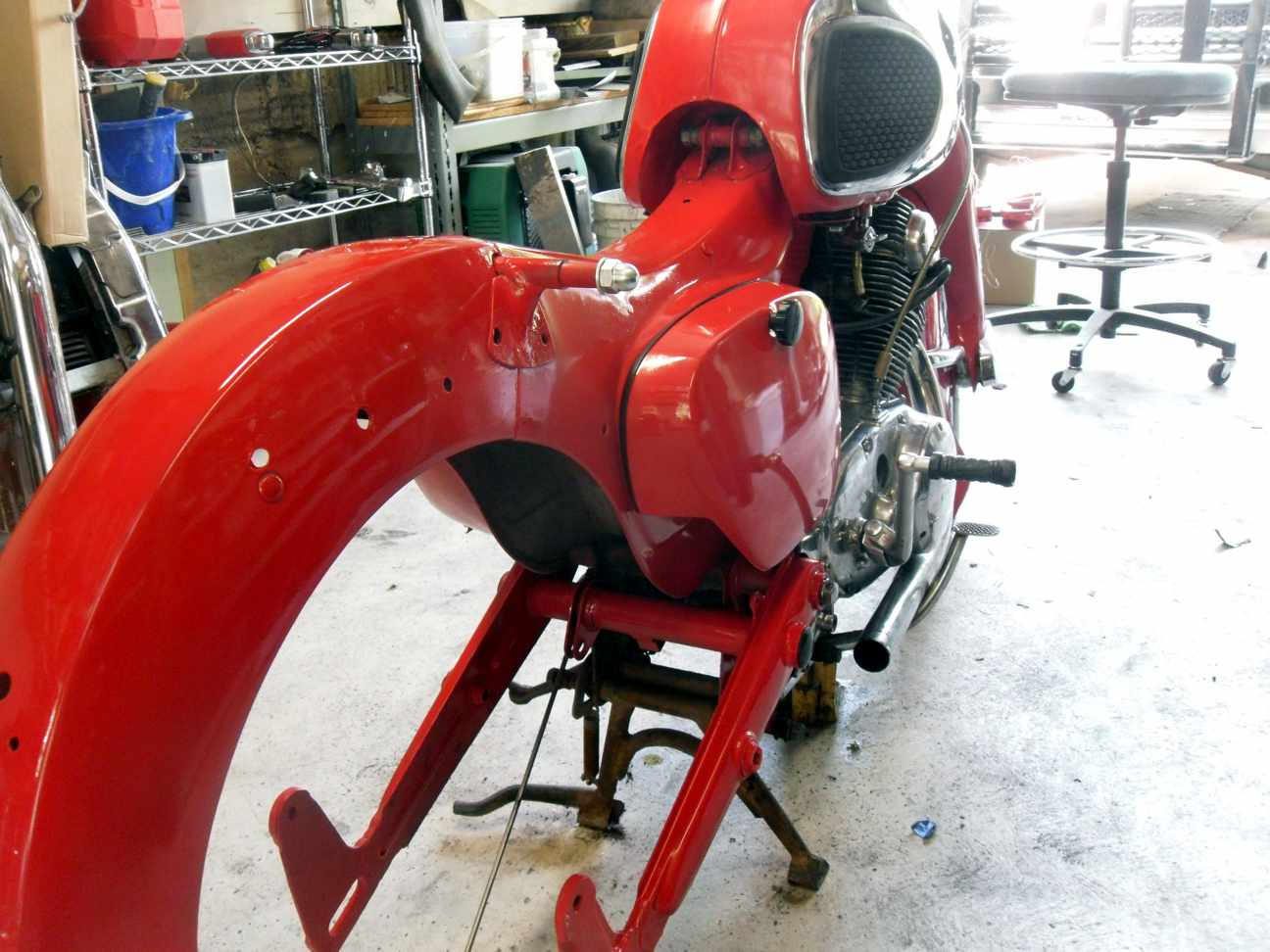

Ongoing DreamOngoing DreamPaints done - a few minor touch ups to do - New front and rear wheels, spokes and tires. Now comes the hard part - assembling the rest of it and the eternal chase for misc. hardware
