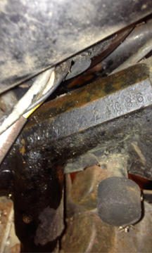

I thought I was missing a number of the serial set for the frame, but it's not there. Here is a photo of the serial taken from the frame.
Head stock serial numbers

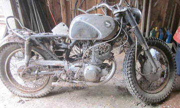

Here is a photo of how the bike looked when i picked it up. I have since started to disassemble it. I'm thinking of sending the engine to CT Trail Bikes in Texas to have it rebuilt. From the photo's I've seen the guys does good work. Any suggestions on where else I could get a show quality rebuild on the engine.

Goodysnap wrote: More than likely you missed the 1 when you read the frame number too. Goody
Goody,
He didn't miss a number on his frame. Engines in '61 and '62 had that extra "1" digit in the number string.
