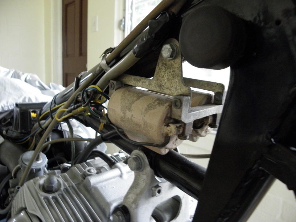

Hi all, My CL77 had been dropping the right cylinder when starting then it would seem to be ok after running a little. Well now it runs on one cylinder and if it picks up the right side it cuts out as I give it some throttle. I checked all the connections and got a new plug cap and plug, then I swapped the plug leads and the problem changed sides so the right coil appears to be toast. I have seen several threads on Dream coils but mine has 2 separate coils and I am appealing to the members here for the best solution. A search on the web produced zero results for NOS coils...So, What do you guys use and who do you get them from? Thanks, Tim in Florida.

I just installed a set of coils from Dynatek, #DC10-1. Easy install, work great.

Coils for the CB350 are exactly the same, I use them as well, the only difference is the bracket.
With a bit of creativity you can install them just fine.
