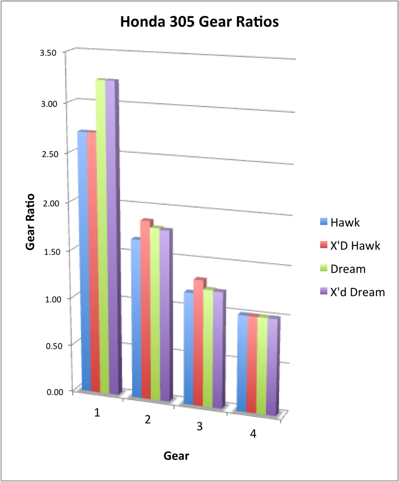

Post by G-Man » Sun Jul 19, 2015 1:31 am
My graph, below shows the ratio change and spacing with "X'-d gears compared with regular setup.
You can see that the Dream ratios do not change very much on "X"-ing.

Post by oldbikedude » Sun Jul 19, 2015 9:20 am
Wow, thanks G-man....that is a great chart. Thanks for sharing your knowledge. I'll be leaving my ratios alone.
