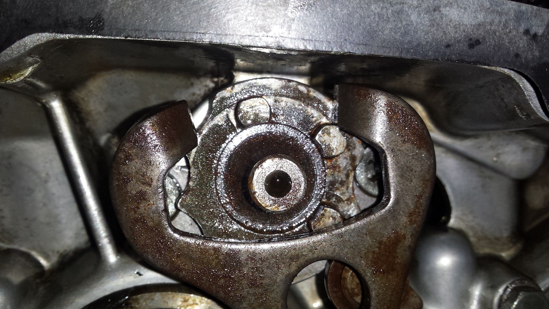

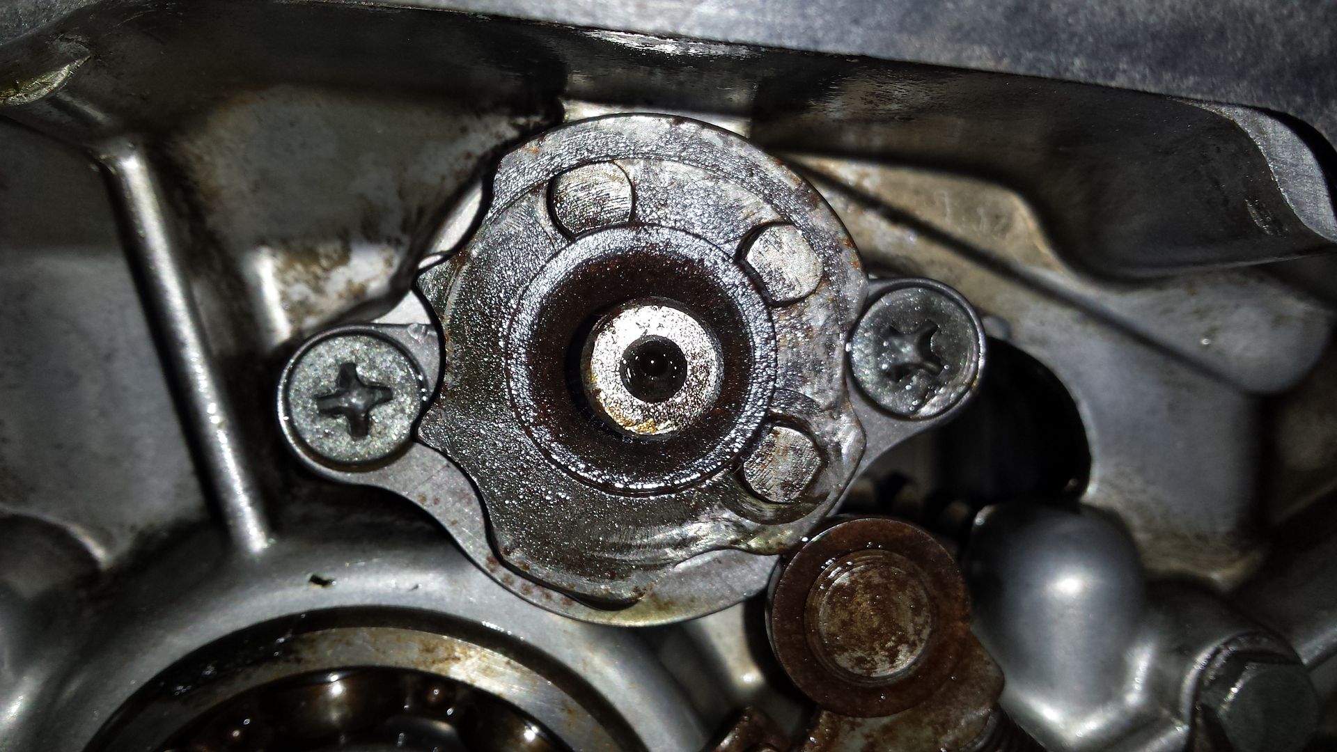

It was acting a bit like it had a broken or absent shifter return spring but its there and good. i would have to manually return the shifter to center to be able to get it to click again. so i removed the clutch assembly, got a feel for the shifter linkage then put the cover back on to see what happens. for the only time, it appeared to go through the gears, and then bam, it "jammed" so i took the case back off to see what said jam was. What i noticed was how poorly the gear shift arm and gear shift drum interact. it appears the drum does not fully toggle over when the arm is pushed. now ill say im pretty sure if i yank away at the shifter while rolling the back wheel it will "free up" again.

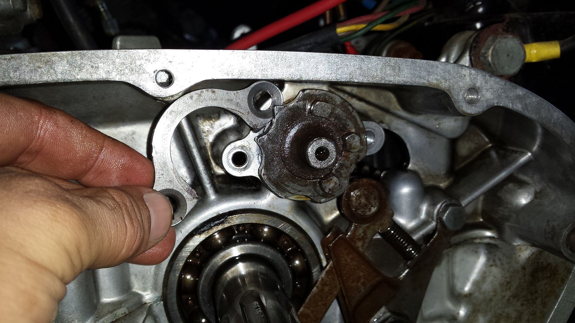

Below is a picture of the drum with the arm pushed all the way one way and released and the other photo is pushed the other way and released. you can see im kind of stuck in limbo as it hasnt moved enough to allow for another shift. occasionally the assembly seems to work right allowing for me to get in a few shifts but nine times out of ten its as described.

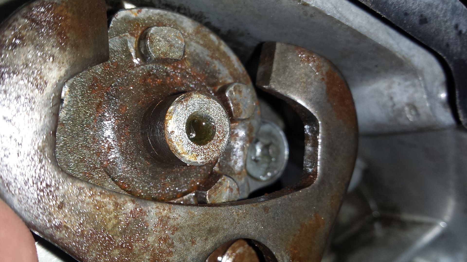

Pushed right and released

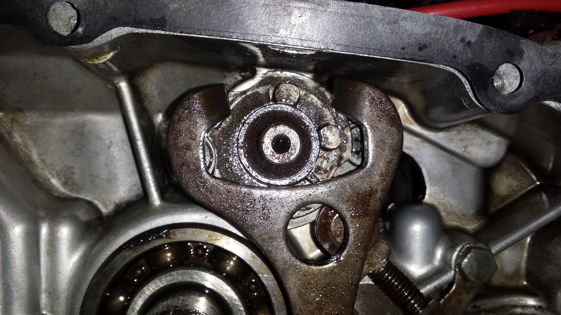

Pushed left and released
