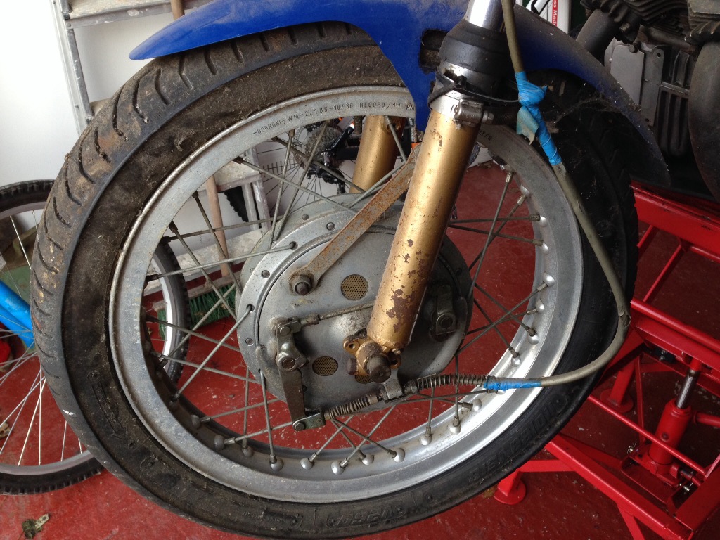

Can anyone tell me if there are any forks that will swap directly into my 65 cb72 yolks and will use the original wheel. Mine had a plastic front mudguard held on by jubilee clips. Or should I restor my forks and weld some lugs on to mount the mudguard properly.
This is a race bike not original.

Those steel legs look original..............its the fender that needs custom stays. Alloy legs from later models may be easier to work with.

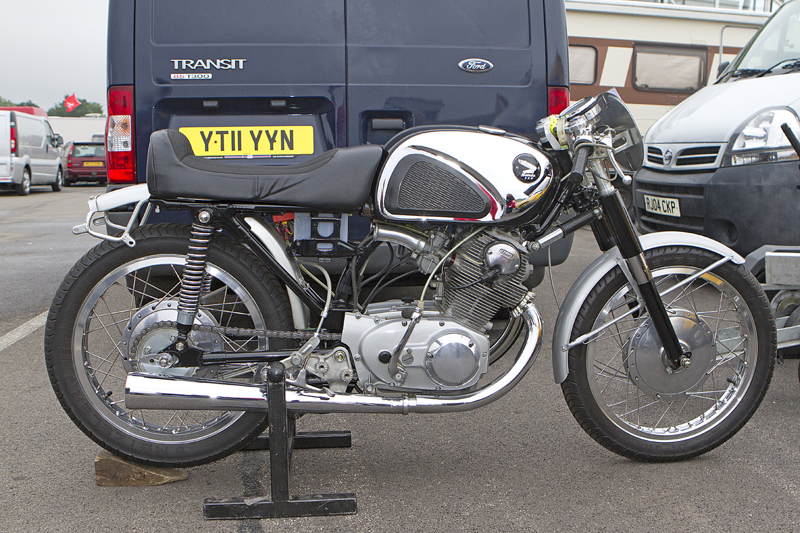

Forks from a later Honda, such as a CB250 / 350, could be fitted but they still wouldn't have a bracket for that particular mudguard. My racebike has a plastic mudguard with CB350 (I think) forks.
The steel CB160 / S90 front mudguard is popular for the '60s Honda GP look. See pic below....
Fitting your wheel to another set of forks isn't going to be a problem. The 15mm spindle size is fairly common. Even the GT750 Suzuki wheel in my racebike has a 15mm spindle.
CB72 with_CYB_parts_fitted small.jpg (114.84 KiB) Viewed 5670 times
