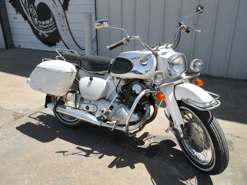

Has anyone installed a lightbar on their dream?

I'm not sure what you have in mind, but wiring more lights shouldn't be difficult, just keep in mind that these bikes don't have strong charging systems and you could easily go too far.

The Dream charging system already can't keep up with the headlight on. Adding any lights will make it worse.

The two lights like on a police bike. A bar under the headlight.

Passing lamps. I've seen it done, but I personally wouldn't do it unless I'd upgraded the charging system with a modern voltage rectifier/regulator and used LED bulbs throughout. Even then....
