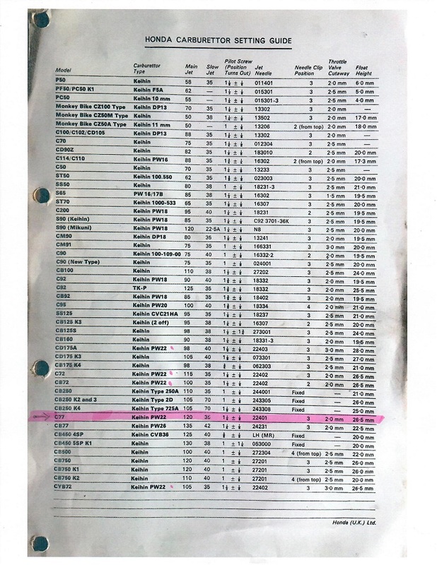

garncarz
Posts: 210
Location: York, PA
Re: Won't start after carb rebuild
Post by garncarz » Tue Sep 08, 2020 5:40 am
You said that it wasn't running well before the rebuild. Valves, points, carb. Typically in that order.
garncarz
Posts: 210
Location: York, PA
Post by garncarz » Tue Sep 08, 2020 5:43 am
A wise man once said: "Most carb problems are electrical". Set the valves and the points, eliminate the easy variables.

Best thing is to set the carb to stock setting first, it may not be perfect that way but at least it should start on stock settings.
If it still doesn't start and as the bike has been standing through the winter it may be nothing more that stale fuel.
Drain the float bowl and put in some clean new gas and see what happens. If it starts, the fuel in the tank may be OK, in my experience fuel tends to go stale in the float bowls much quicker that it does in the tank.
