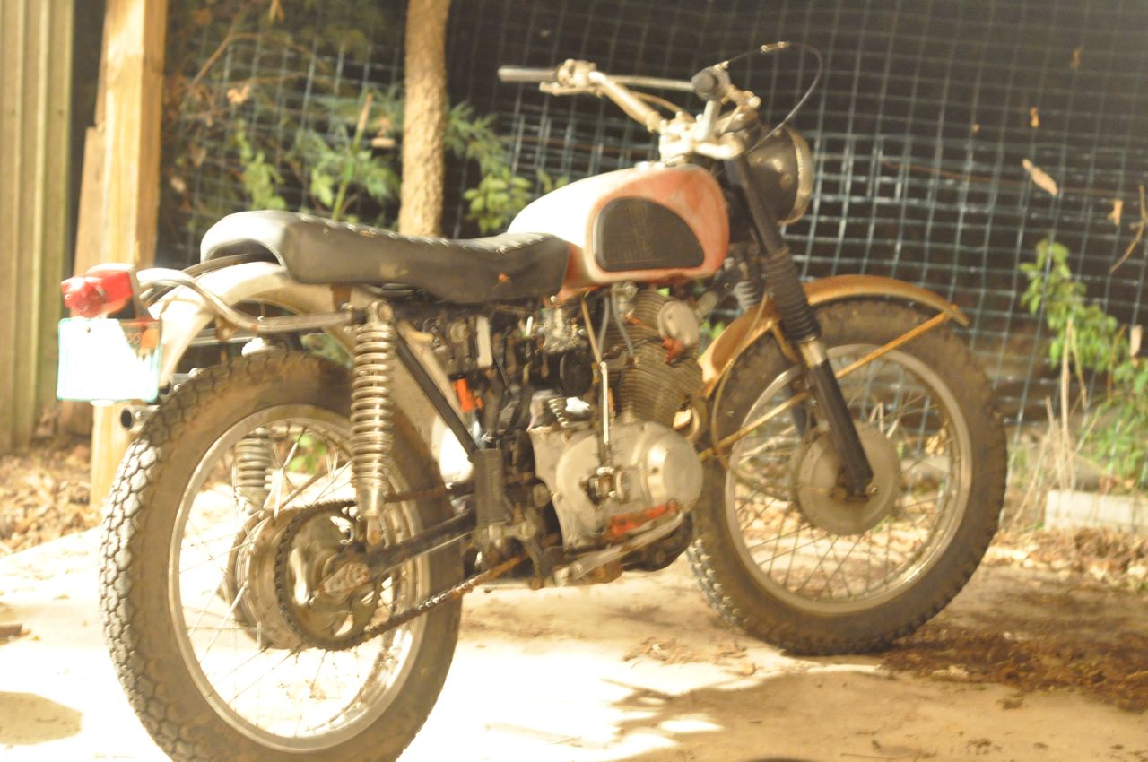

This is my first attempted resurrection. Bought this Scrambler off eBay a few years back. Barely running at the time. It sat in my garage for a few years as my resources and attention were drained by career demands. Now I'm at a place where I can really work on it.
Not attempting to restore this bike to any kind of 'original' state. The engine appears to be a CL77 305 while the frame is a CL72, I believe.
I had a local shop look at the engine and charging system. Compression is good. Tank is clean on the inside. Installed a new mikuni carb and new spark plugs.
The bike now runs, but not without problems. Was barely able to ride the bike home 8 miles. Clutch plates seem to be sticking together as shifting from neutral is a roll of the dice with many attempts resulting in the bike going directly into gear and killing the engine.
The other drama on that ride home I believe was due to a shot rear bearing. After stopping to refuel, I couldn't even push the bike. Additionally, I could barely get it to do 40 mph. Previously, I had taken the thing past 50 mph. When I got home, smoke emanated from all over the bike. I suspected the rear drum brake had locked up somehow, and touching the hub burned my fingers. After several hours of cooling, the bike pushed easily. That's why I suspect a bearing rather than the brake.
Other than engine oil, are there any other fluid levels to be watchful of? Lubrication points?
Will continue to update this thread as I make progress on this Scrambler.
thanks for any advice in advance,
mtf

Hahnda
Posts: 835
Location: Cameron, WI
Post by Hahnda » Thu Jul 14, 2011 4:33 pm
I think you have a CA77 engine in there.
MrTexasFreedom
Posts: 7
Joined: Thu Jul 14, 2011 4:29 am
Location: Austin, Texas
Post by MrTexasFreedom » Thu Jul 14, 2011 4:43 pm
Well, perhaps the engine and frame are matched, then. Looking at a factory-correct CA77, it matches pretty well with what is on this bike. Would that explain a single carb vs. dual?
