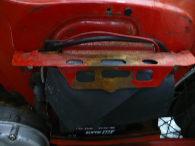

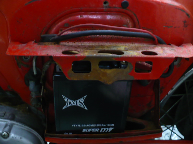

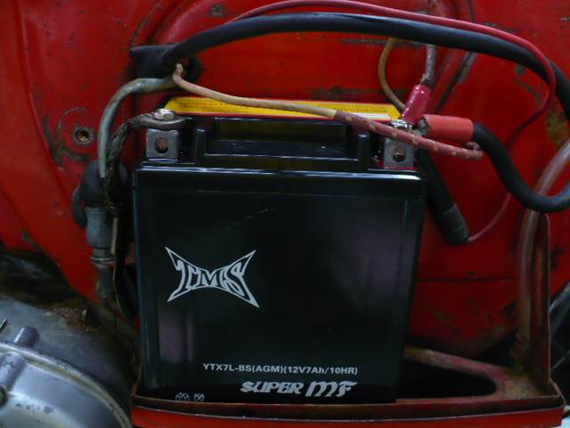

I was getting frustrated at the low availability of the JB-3 batteries for the early Dreams. I use AGM batteries in my CB77s and my 4-cyl Hondas, but could not find one dimensionally like the early battery. I have noticed that the AGM batteries seam to have more CCAs than similarly dimensioned wet cell lead/acid batteries. I found one on e-bay for $17 and figured what-the-hell, I'll try it. Item 140570492429 . It is a YTX7L and cranks the starter extremely well. I've done six 5-second cranks in rapid succession and the battery doesn't show a hint of weakness. The battery/tool tray holds it in, and I put a rubber sheet over it to insulate from grounding out the battery. The dimensions are 4.5" x 2.81" x 5.18". I have no info on the CCA of the battery or any personal long test data, and am well aware the original Dream batteries were 9Ah rated, but for the price I'm willing to roll the dice and see if it works out.
