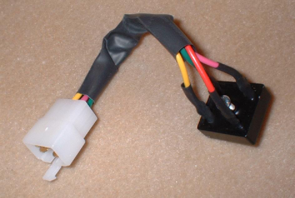

Can you use the solid state modern rectifier on the Honda ca77?
I used one on my 1961 Triumph as it used a similar old type which was almost impossible to find and it works fine not sure about the Honda.
ca77 regulator rectifier
I've been using the Radio Shack one for a couple years now with no problems.
http://www.honda305.com/forums/viewtopi ... adio+shack
- Posts: 87
- Joined: Tue Apr 20, 2010 7:04 pm
- Location: Ormond Beach, Florida, USA
Solid state rectifier
I put one on my 67 S90 several years ago..worked great. Then bought my 67 CL77 in may and immeiately replaced the stock one with a solid state rectifier from the same guy who supplied the S90 one...oregon motorcycle parts...23.00 great quality and with the correct connector!
Rectifier replacement
RetroBikes in Port Angeles Washington has a modern replacement rectifier that looks just like the original.
