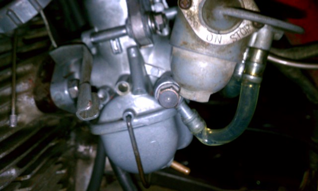

Post by cleg » Sat Aug 20, 2011 9:29 pm
Would you agree that this is a LH carb?
'66 CB77 '75 Rd125

Post by Goodysnap » Sat Aug 20, 2011 10:09 pm
Maybe someone took a right carb and put the choke lever on it? As you stated the fuel port should face inside. I'd be looking for a square left carb.

Post by cleg » Sun Aug 21, 2011 12:16 am
Ok, I thought that this had to be a LH carb bc of the choke lever, but as you state it is a RH modded to LH with an incorrect throttle valve.
