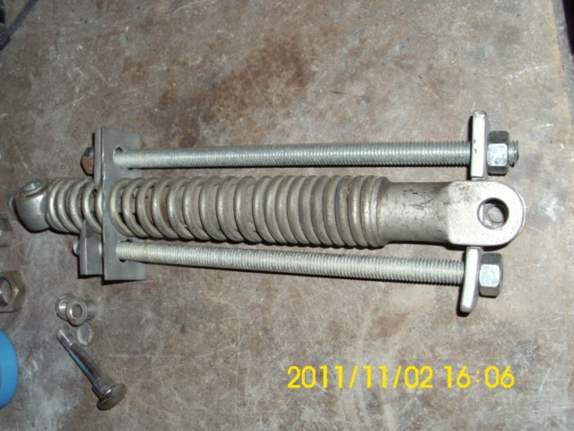

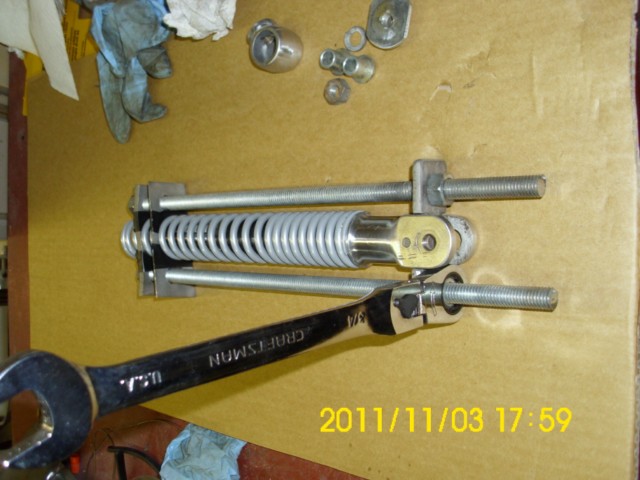

OK, I decided to tackle this problem by making a spring compressor to disassemble the shock/spring combination. I cut two brackets from 1/8” steel, another bracket from sheet metal and used some threaded rod for the screw compressor.
Here are some pictures of the dis-assembly, restoration, re-assembly and the home made spring compressor.

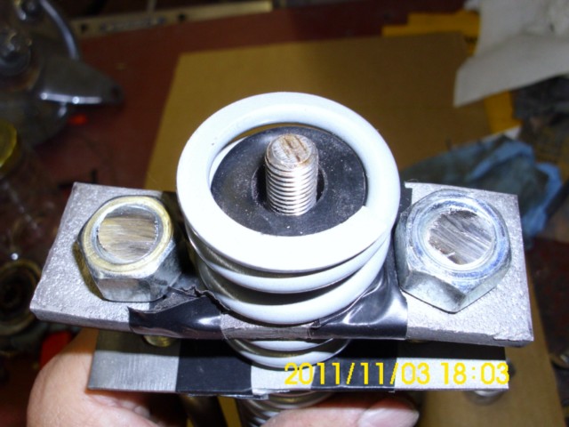

Next I used the spring compressor to compress the spring off the shocks upper shaft, then un-screwed the top retainer. At this point the spring can be removed from the shock.

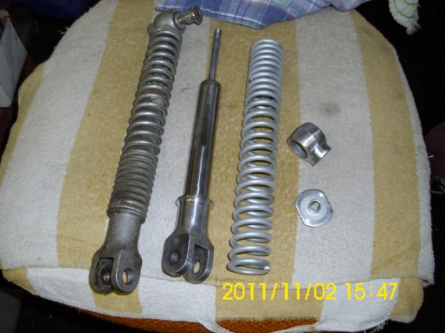

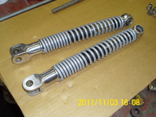

The springs appeared to be originally chrome plated, but I opted to powder coat the springs silver, after a cleaning and bead blasting. The upper and lower retainers, which are aluminum, were polished on a light de-burring wheel, as was the shock assembly. The plastic liner between the spring and shock was cleaned, then painted black.
The shock originally was un-painted so I opted to leave it that way, but gave it a light coating of protective sealer prior to re-assembly.
the compressor installed

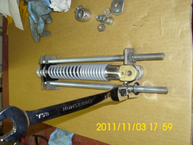

I used a ratcheting wrench to compress the screw

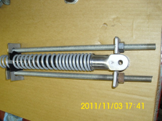

To re-assemble I attached the spring compressor, wound it down and attached the upper inner retainer. Once this is screwed onto the shock upper shaft the spring compressor can be removed and the top retainer re-attached.
Here are some additional pictures of the compressor.

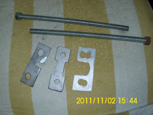

The compressor parts. The thin sheet metal bracket on the right is only used to prevent the thicker bracket from slipping off the spring when it is compressed. The bracket in the center goes between the shocks bottom mounting plate.
close-up of the spring compressor upper plate. I bent and ground down the edges to better fit the springs angle.

Before and after shots
view of one assembly before re-storation
final result
final result
