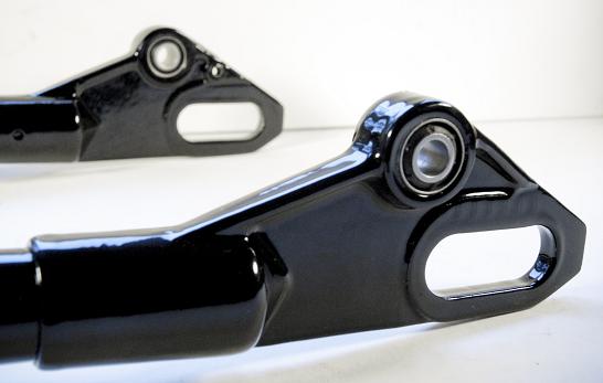

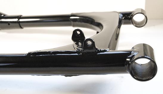

Post by advmaxx » Thu Nov 17, 2011 10:29 pm
The front mount for the chainguard should be a low, wide u-shaped bracket welded to the top of the swingarm (see first photo). There should be a threaded nut welded to this as a fastening point. This is commonly broken off as a result of vibration. The rear of the chainguard bolts from the inside to a threaded hole in the cast end of the swingarm, just behind the shock mount hole (see second photo, on the far side). It appears in your photo the chainguard has been welded or brazed directly to the swingarm over this hole. If it was brazed, you should be able to reverse this repair fairly easily.
Also inspect the battery cage, where it attaches to the frame. Quite often this too is prone to vibration- related cracks and breakage.
