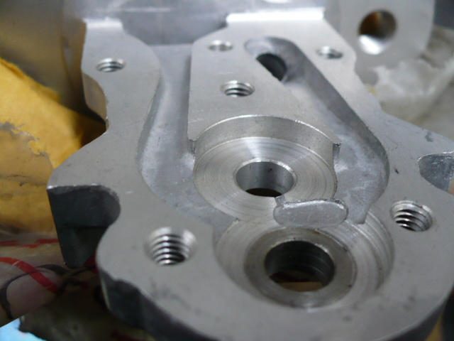

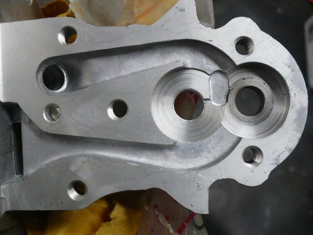

Hats off to you for sharing your pump rebuild. For reference is a NOS oil pump body. As noted the drive gear does take 2 thrust washers, one on each side of the exterior housing.
FWIW, Honda engineered a reliable motor, provided proper maintenance was done. Even abused these engines took a licking and kept on ticking. With that said, I wouldn't recommend shaving off some of the housing thickness. Honda designed the pump to be used with the paper gasket as is. I think you are wise to disassemble, inspect and rebuild the pump replacing worn or out of spec parts.

Thanks Hoosier for the NOS pictures this will give people a great comparison to look at.
