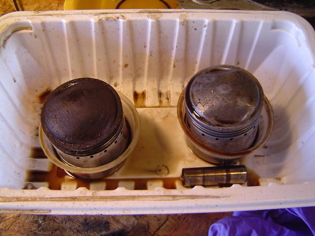

- Pistons, cleaned and measured at 59.65/59.67

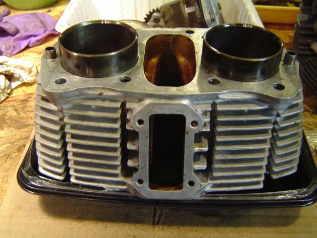

- Cylinders, cleaned and measured at 60.0

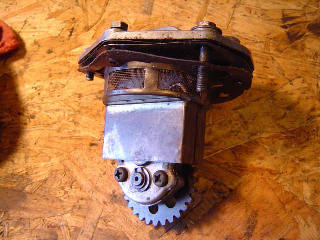

- Oil Pump, started to inspect, clean, and tear down.

I cleaned mostly with simple green, which worked wonders on just about everything to include all of the nooks and crannies but I had to use a lot of elbow grease. I used brass brushes, steel brushes, old toothbrushes, and other to clean between the fins and all the surfaces of all.
During the piston cleaning, simple green worked well but had to soak, brush, soak, repeat......
Cylinder after cleaning, came out really well compared to what it was.

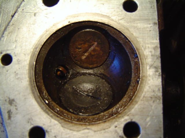

Need to tear down, clean and lapp the valves.  Did the pour test, as described in the forum, and they moderately leaked
Looks like it is in good shape

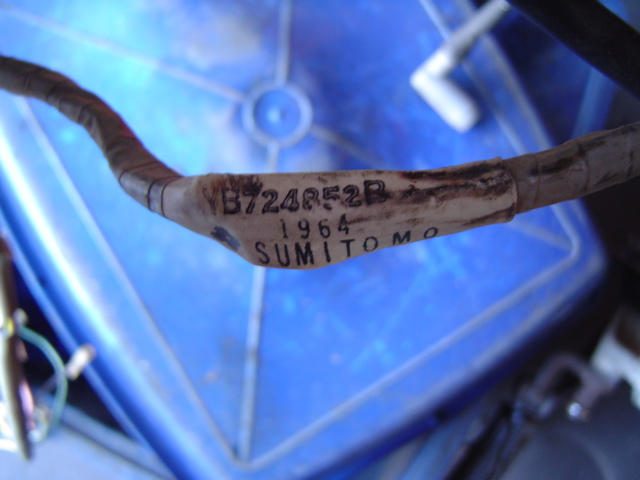

White tag on wiring - 1964

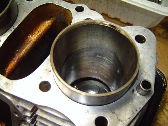

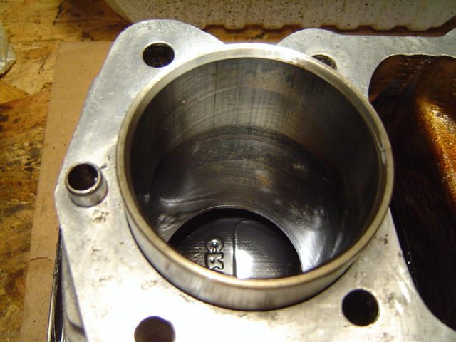

The cylinders seem to be in good shape and spec out as good within tolerences. What is the best way to hone these cylinders?
I have checked all the parts stores and all they have are 4" honing stones for auto. I have not yet checked the cycle shops around.
Any suggestions? Comments?

Post by davomoto » Sat Jan 21, 2012 4:58 pm
I believe I puchased a suitable size hone at Kragen / Oreilly auto parts store. Otherwise, search Ebay or Amazon.com for either a stone or ball hone to fit.

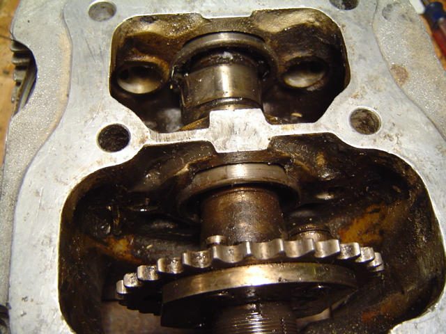

Cylinder Head Teardown
Post by ASG85 » Fri Jan 27, 2012 6:19 pm

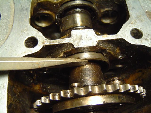

OK, I have began the teardown of the cylinder head and have removed both cylinder head side covers, Inlet/Exhaust rocker arm pins, and the right side cam shaft. I cannot, however, remove the left cam shaft. It will not release from the Cam Sprocket. Any suggestions? (See photos)

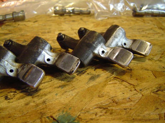

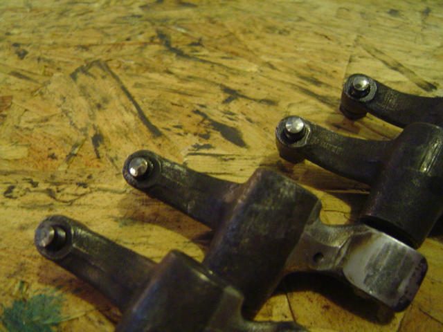

Next, are the rocker arms. Is this ok wear on all four of them?
The Tappet adjusting screws, are these ok? Bill Silver manual says look for "flattening"
Screwdriver marks the split where the left cam shaft should release from the cam sprocket??
All four valve rocker arms

Post by lix » Sat Jan 28, 2012 4:25 am
I also had a lot of troubles removing this part.
I had some hard wood between the camshaft and the egine frame. Otherwise the bearings came out when I hit the axle. Then put a nut on the axle and hit it wit a hammer. Hope this helps.
I can take a picture if you want when I'm home. It can be very stuck ;)
