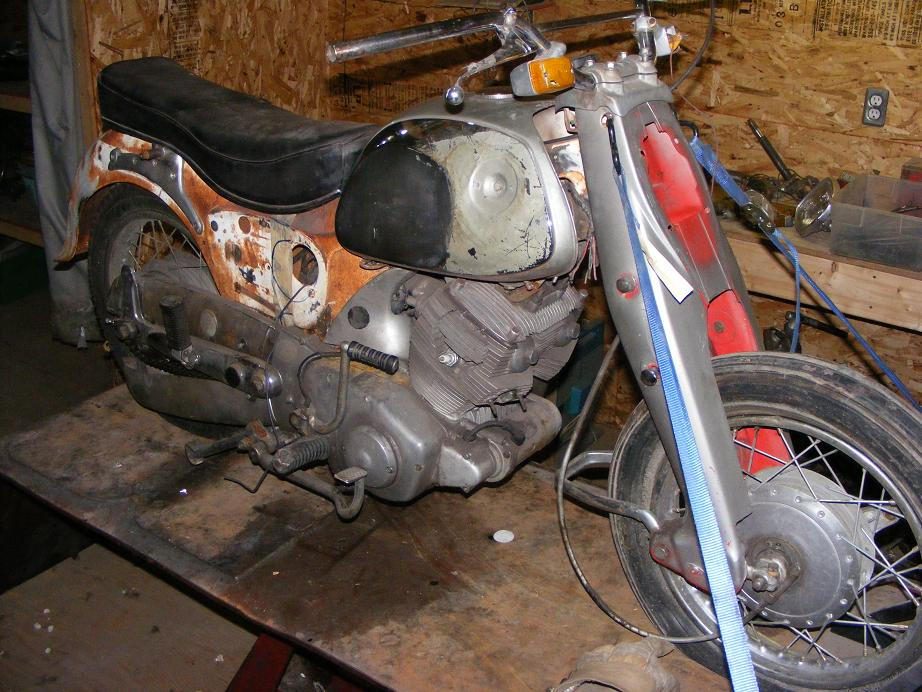

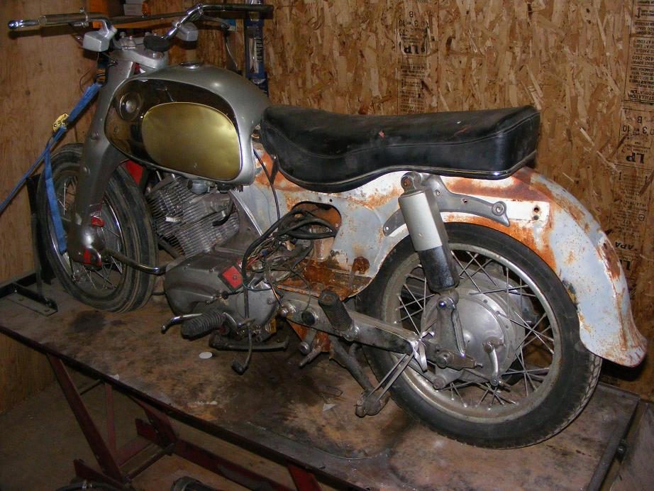

I try for a picture not sure if it will work.

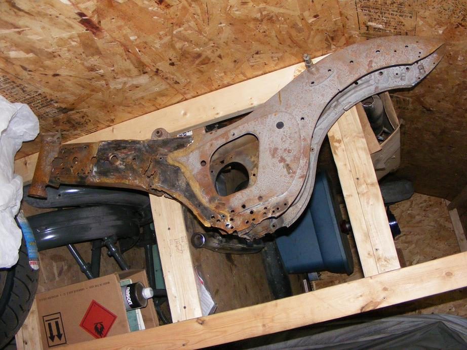

The frame been changed,I have the original frame but in VERY bad condition.The lower part of the frame been saved and swaped on another frame.Need a lot of work,but motor have a good compression.Bike is 95% complete,with title!

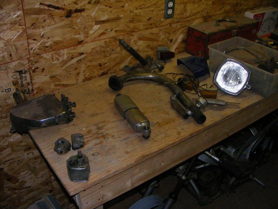

Question,I need front exhaust pipes,I have compare the pipe with olds cb77 and they have a very small difference in bent,did the c77 front pipe are the same as the cb77 or maybe by change the c77 pipe will fit the c76....?

Hi,
You have a very rare bike, a C76, these bikes don't come up that much.
Welcome to the everything is just a little different show, because that is what it is.
First type dreams : C70 / C75
Second type dreams : C71 / C76
Third and last type dreams : C72 / C77
The C77 has a wet sump engine, the C76 has a dry sump engine.
The C76 has ignition timing via the crank, the C77 has ignition timing via the camshaft.
Is it a Japanese or non japanese version ? (shifting is different)
The list of differences goes on and on.
For the mufflers and pipes the same story, these seems to be the same, but are not.
Some bodyparts of a C77 will fit, some not.
Take a look at www.cmsnl.com for parts lists of a C76 versus a C77, and you will see what I mean,
Good luck with your rebuild.
Maybe you can contact Jelle, a Dutch specialist on early Honda dreams, he is a member of this forum,
Jensen
btw, I'm interested in your winkers, can you make and post a detailed picture of them ?
