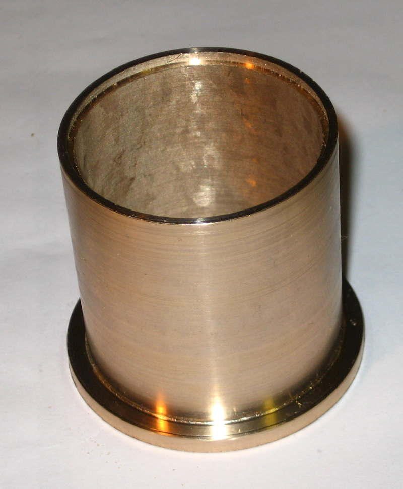

I made my own bushes for my CL77 out of bronze rather than the aluminium ones that Honda supplied. All of the other parts do not really wear.
