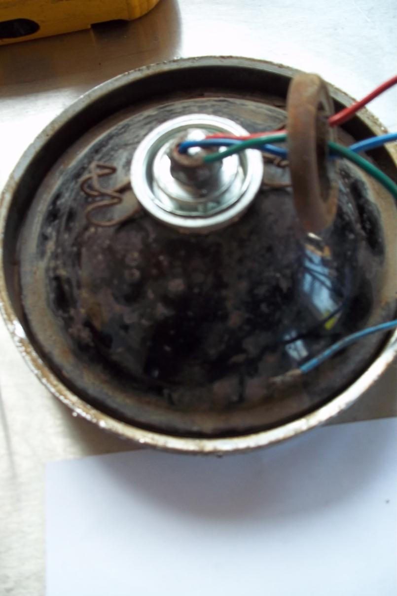

hi all.my honda m e had the headlamp bulb blown, and have been looking for one world wide, no luck, its a 3 pin fixing 6v 25/25, i have found 6v 25/25 but they have 2 contact points, so looking round, to see whats about, i took the headlamp off my cb72 1961, which has the 2 point conection, but which fits into a holder, i tryed that holder into the headlanp of the early dream and it fits, i can now take the 12v bulb from the cb72 out and replace it with the 6v 25/25 ones i have.will post a pic of the parts. alan

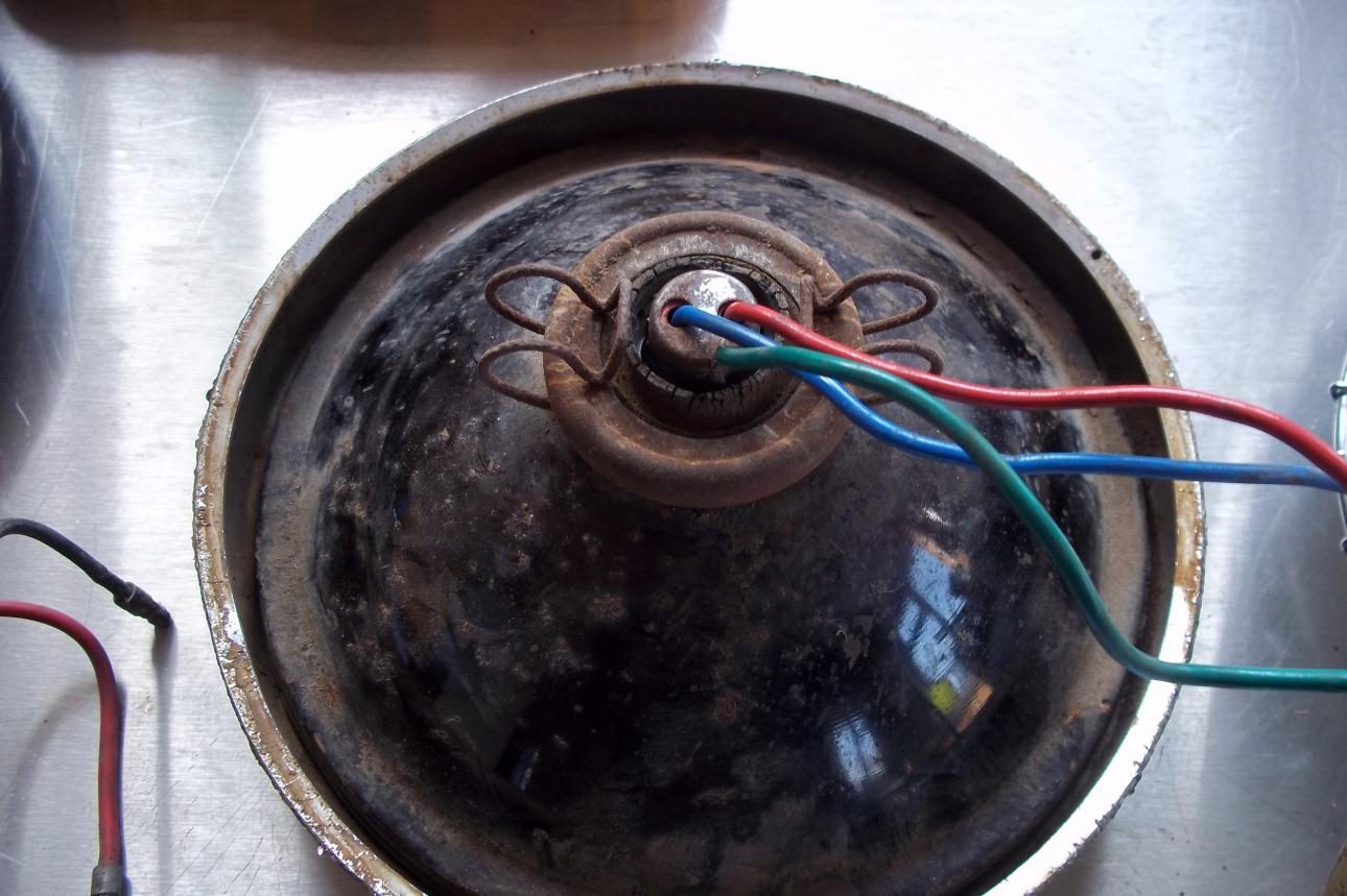

another pic

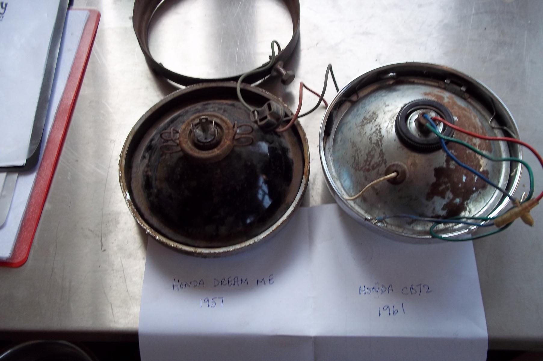

this is the cb72 , bulb holder fitting into the m e headlamp.

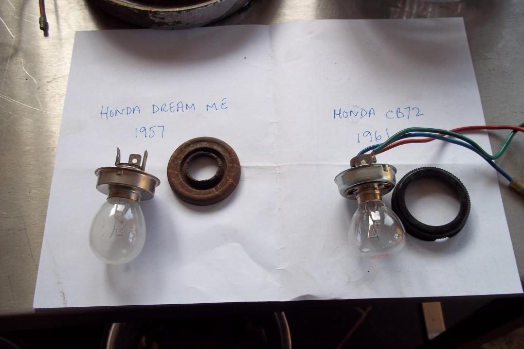

now with the dream me bulb holder ring.
