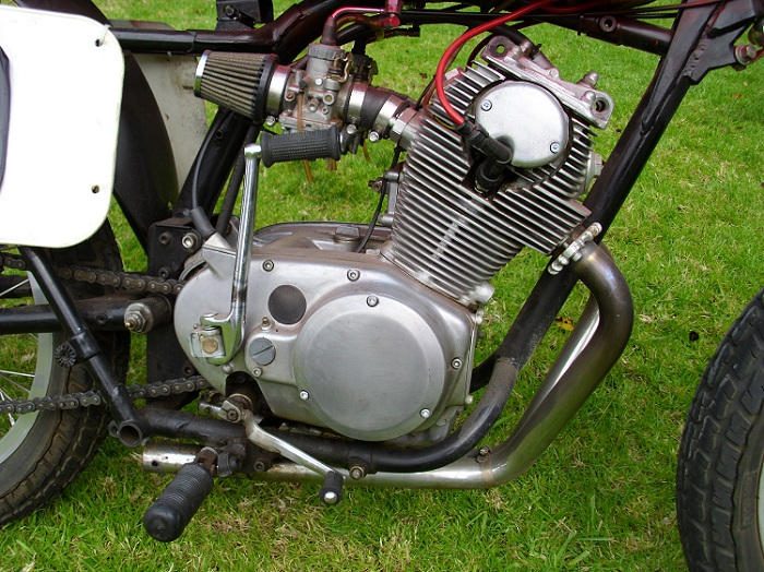

There's a way to convert a stock 305 dyno (with battery) to a magneto (no battery).
I had a racer in the 60's that had one and the bike in the photo has one.
Don't know how it's done or if that would accomplish what you're trying to do.
If you're interested, my pal who owns the bike and I had talked about reverse engineering it next time I'm out in SoCal, maybe next month.

I'd love any info available. Did you convert that bike to right hand shift as well? If you could fill me in on that as well, that would be awesome. After the wreck, the left foot doesn't work so well...

I'll let you know what I find out about the magneto conversion.
Sorry about your foot but I'm not sure if the right side shift is a practical conversion.
It was originally done for a flat track engine (turn left, go fast, repeat), I'll ask the current owner if he knows anything about it.

Hotshoe wrote:There's a way to convert a stock 305 dyno (with battery) to a magneto (no battery).
I did it with a pair of Honda 50 coils and re-wiring the alternator. You need to separate the connections in the alternator harness and re-wire it to combine one daytime coil and one lighting coil to run each side. I used the early Honda a/c type ignition coils and oversize(Mallory) condensers. The spark advance needs to locked at full-open, so the magnets in the rotor are lined with the stator coils when the points open, to get the most spark energy. With the advance working it's almost impossible to kick start.
