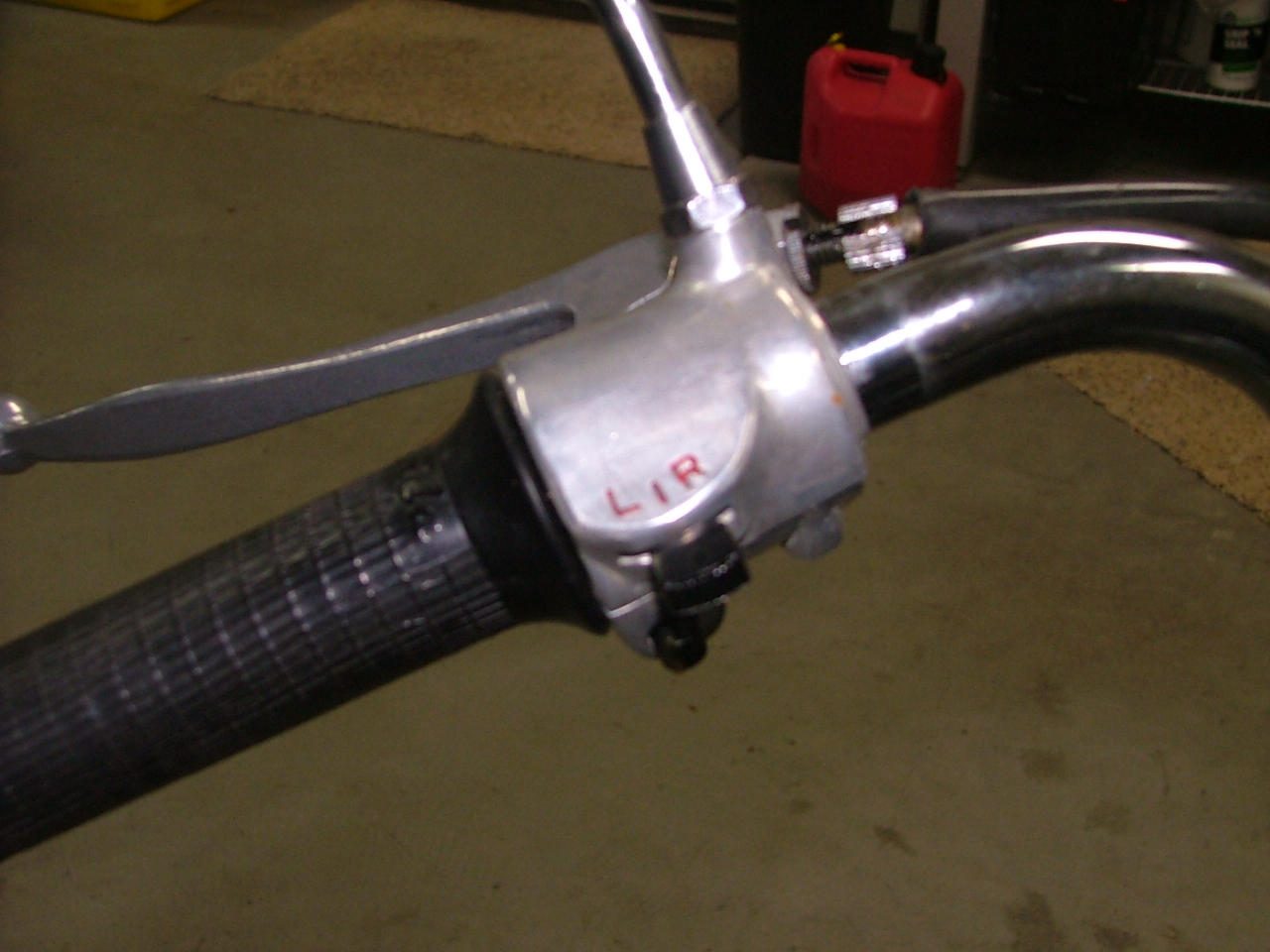

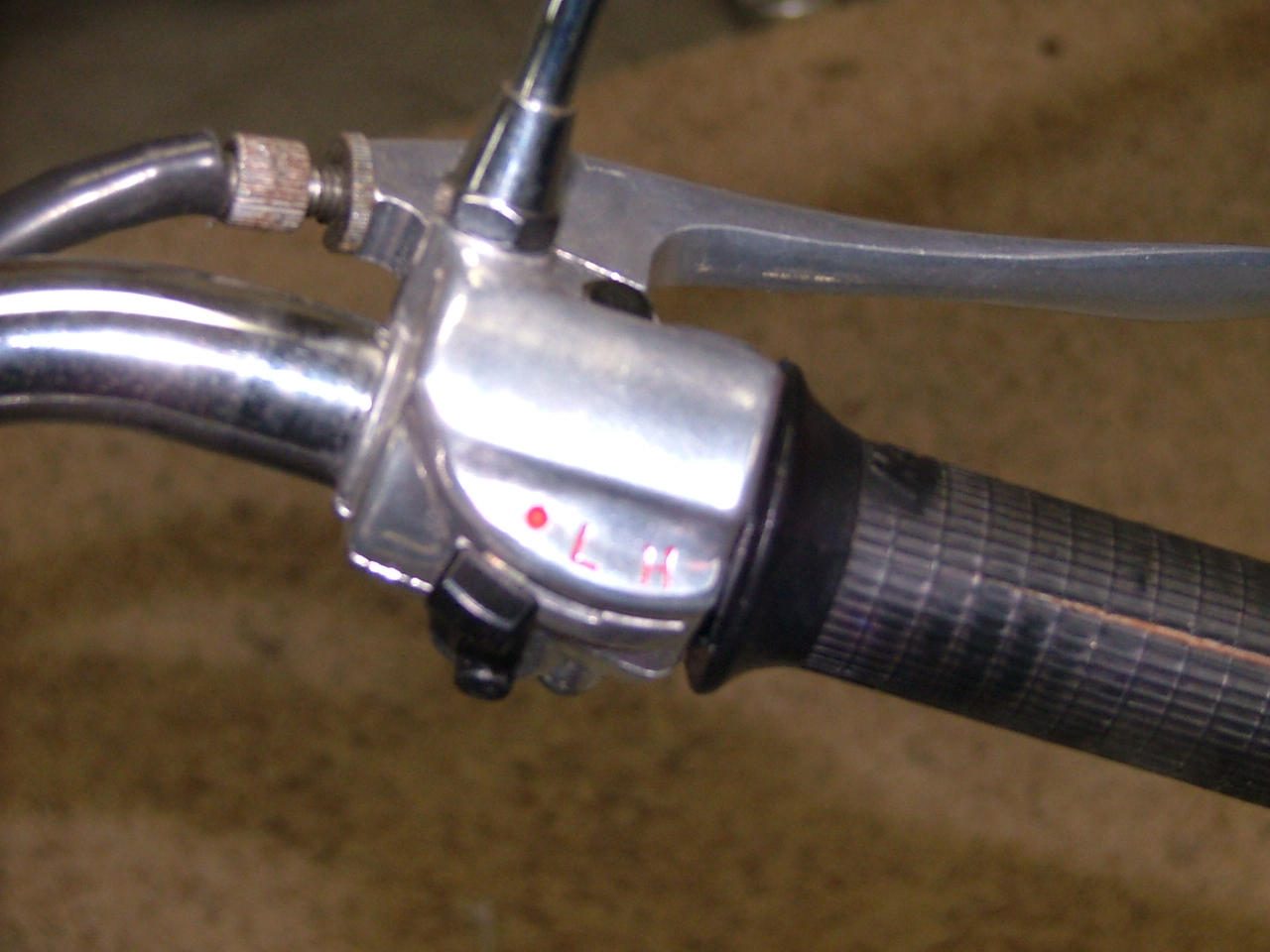

What I did to add Winkers was, I located some OEM left and right switch assys from another year and model Honda that had the same size handlebars as the Dream which is 7/8". In my case, the left switch is from a 1970 SL100 and the right switch is from a 1968 CA175. I would've liked to have had both switches from the same year and model but I couldn't locate a matching set. They look very close in appearance but operate identical.
The only real challenge I ran into was the wires were of different colors for the different models. Using a multi-tester, it was easy to determine the function of each wire. So when it came time to wire them up, I located the respective wiring diagrams for each year switch and sorted out where they belonged in respect to the Dreams wire harness. The right switch had 7 wires coming out of it and only 3 were needed for the starter switch and the hi/lo for the headlight. The remaing 4 wires I folded back and taped them up out of the way. The left switch has 3 wires but all are used so no problems there.
You'll have to buy yourself some wire (I used 16 gauge, 18 gauge would probably do) and a 2 terminal flashing unit (thermal type) and thread the wire from the headlight bucket back through the frame to the flashing unit, the rear turn signals and a power source. For a power source, I tapped into the brake light switch (black wire) and mounted the flashing unit inside where the airbox is located for easy access. Some may have spliced into a wire coming off of the ignition switch, but I found it easier just to splice into the brake light switch.
The switches have the perch for the mirrors and they are of the same mounting diameter as the Dream, so if you have your OEM mirrors, they'll work. What won't work is the clutch and brake levers, they're different. So you'll have to pick up a pair of handles as well, but they are very easy to locate and both are the same. So if you order handles for a SL100 they will be the same as if you ordered them for a CA175

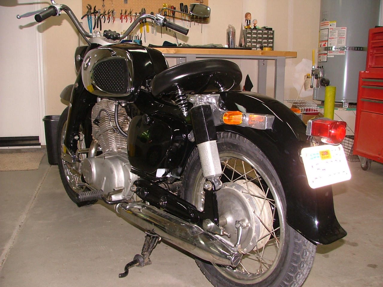

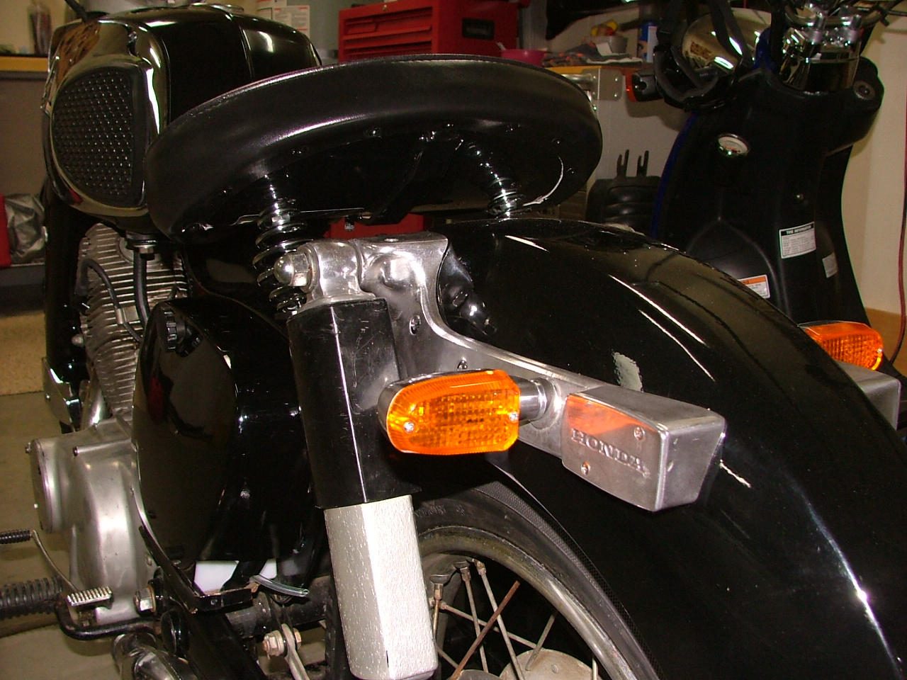

To mount the rear signals, I used an existing hole in the rear fender brace which made a very nice location allowing me to keep the lights close and tight to the fender as I didn't want it hanging out where I can bump it. I haven't found a suitable place to mount a signal up front as of yet, so I have none.
They're not OEM, but they're very functional. They don't look like some aftermarket add-on and your hands don't have to leave the bars which is a huge plus!
Below I've added links to the wiring diagrams I've used and here are the part#'s to the switches I have used.
L/H - 353-110-670
R/H - 353-236-671
Clutch handle - 53178-051-000
Brake handle - 5375-028-672
Switches were purchased on Ebay, the handles are from Retrobikes and the flashing unit was from my local auto parts store. Total investment around $115.00us.
I hope this answers your questions. It's not difficult to wire up turn signals, finding the parts is what takes the time. Good luck and I hope this helps.
