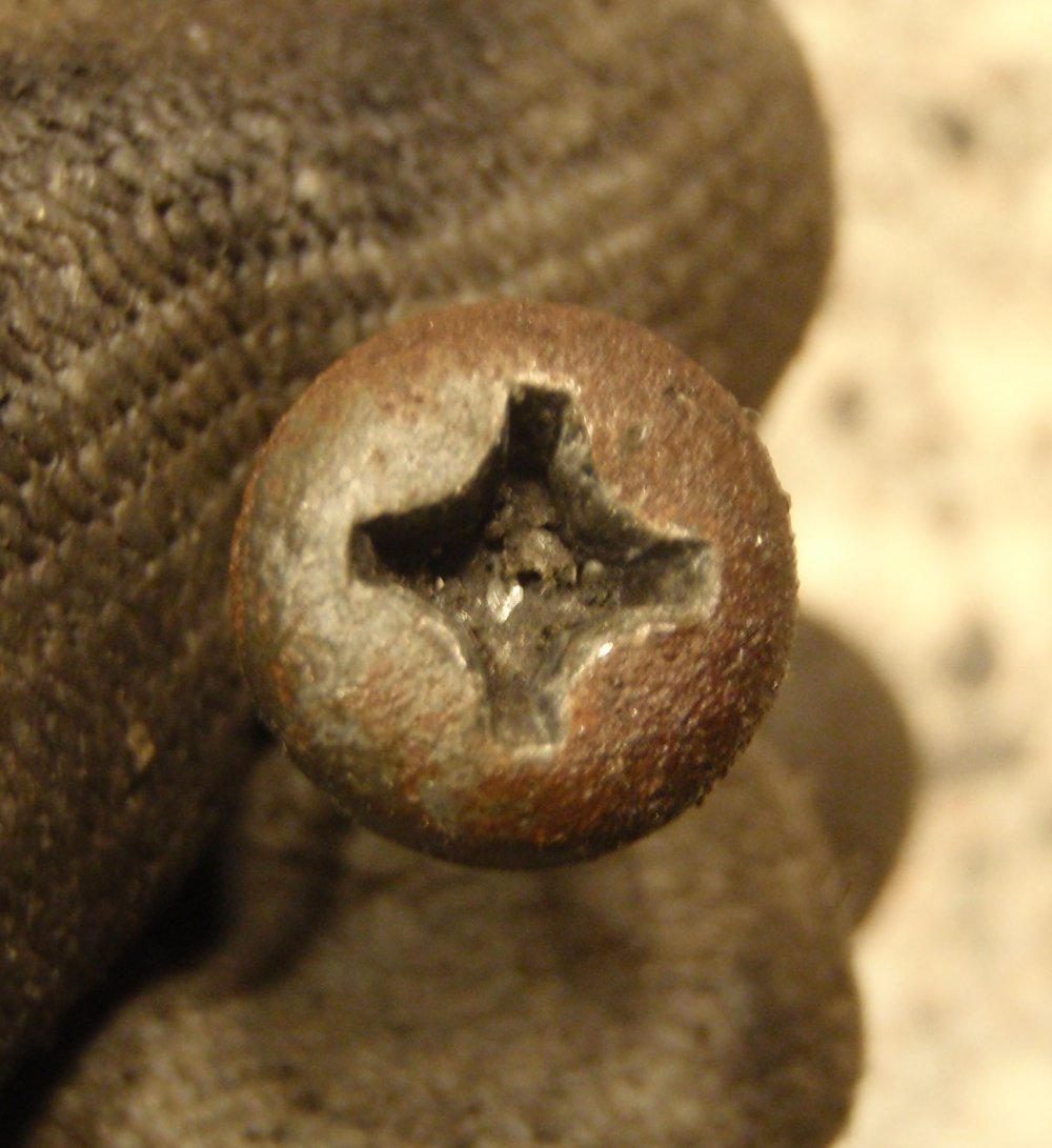

In the past there is a lot said and written about the Philips head screws Honda used in almost all there engines. Everyone who wrench on these bikes and engine know how hard it can be to get them unstuck in a decent and not frustrating way. Since a few years I have found the ultimate way to win almost every battle with these screws. In most cases I save the screws so I can re-use them, saves money and the bike and engine stays original.
What I DON'T use :
Hammer
Impact driver
Chisel
File
Curse
What I DO use :
Patience

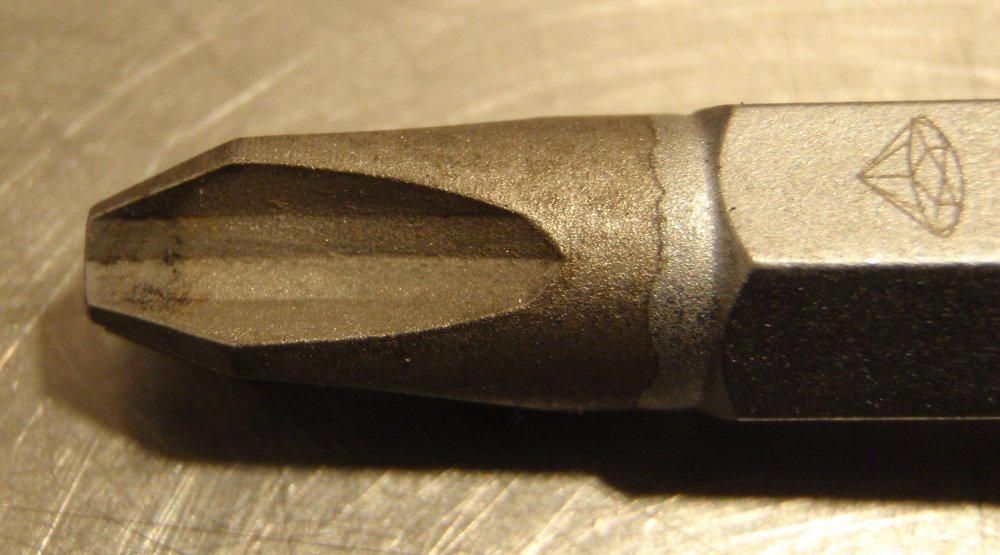

A diamond coated quality Philips head screw driver
Force
The reasons I don’t use hammers and impact drivers are that you will (can) ruin the brittle threads in the old and oxidized aluminium. The reason I don’t use chisels and files are that I want to re-use the bolts and screws so the bike / engine is as original as possible.
So, how do I do it ??

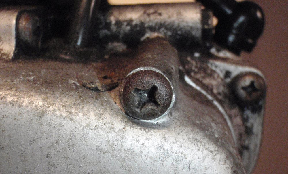

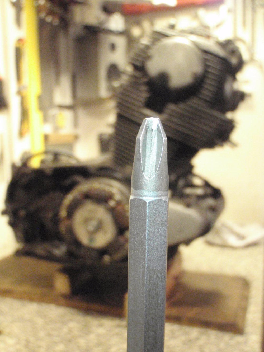

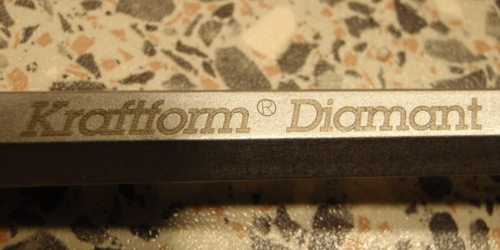

I use a diamond tipped Philipshead screw driver from a good (German) brand, some force and sometimes a little penetrating oil.

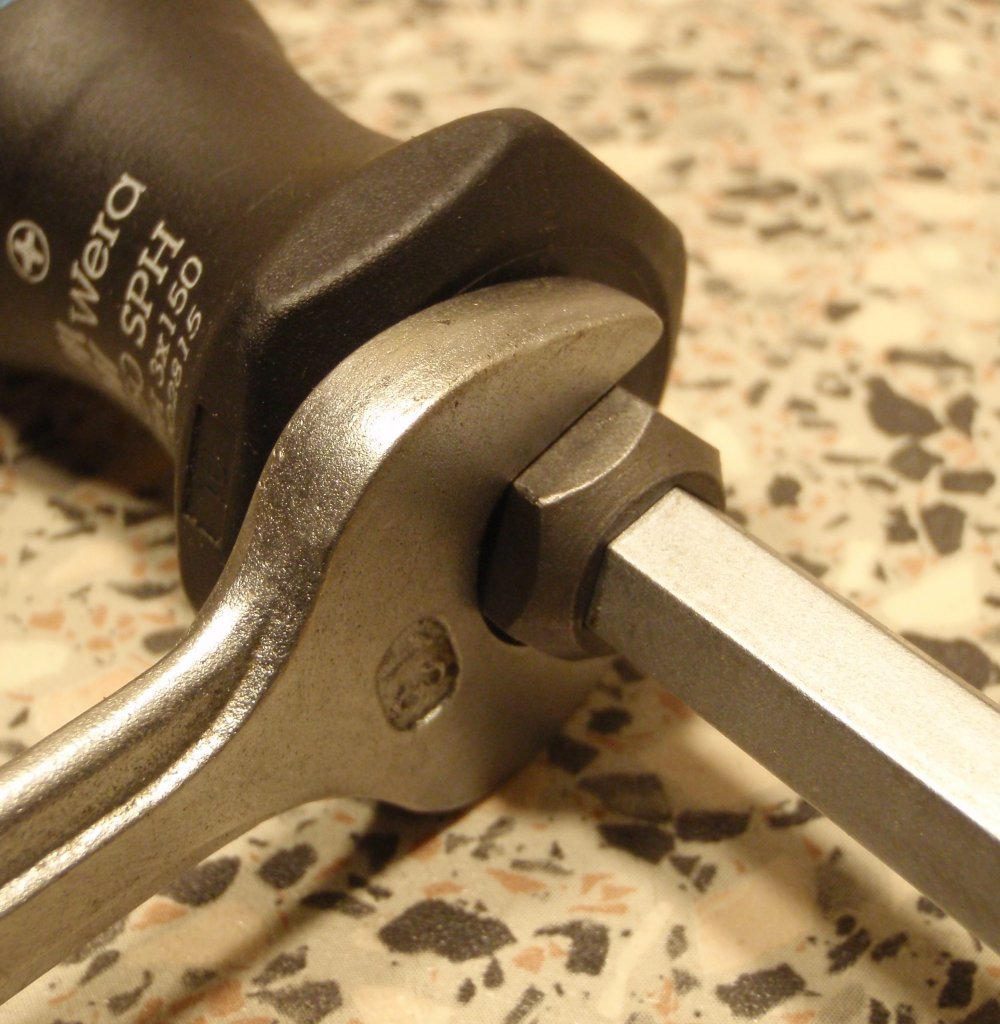

I pictured the step by step process in this thread. So I suggest, buy a good screwdriver and try it at home !
Jensen
Btw, sometimes I spray every screw and bolt with a little penetrating oil, and let it soak for a week or two, it always helps.

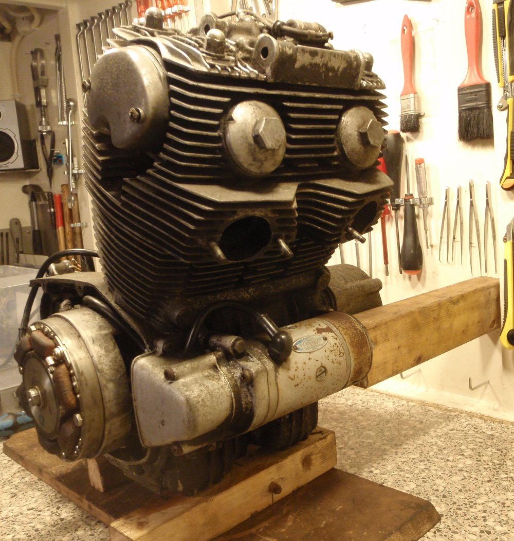

I use a Tee handle screwdriver and always try to move the screws by tightening them a little first. This means that you have a fresh surface in the screwhead to undo it once you have it moving. Like you I try and support the engine and often put it on its side so that I can use my weight vertically.
