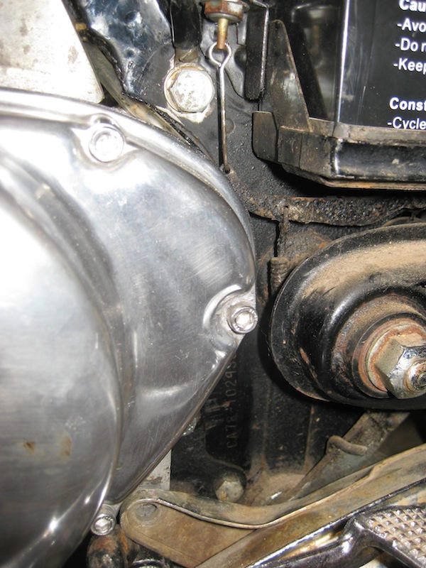

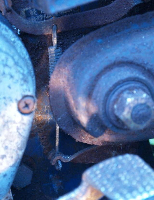

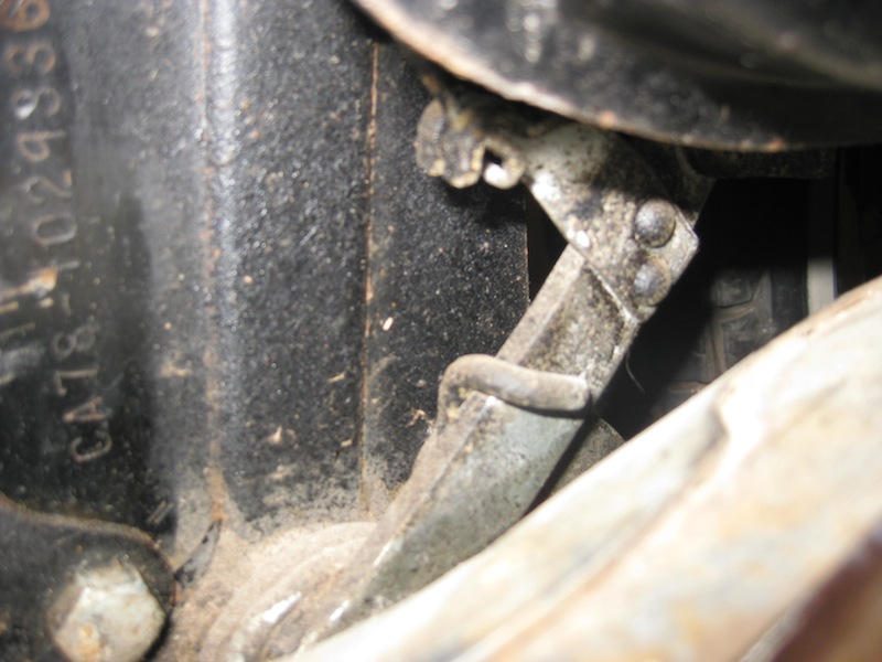

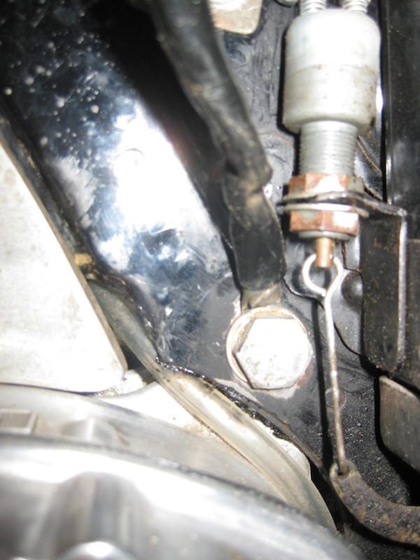

The brake light is on when the brake lever is disengaged and turns off when the brake lever is engaged. The brake light switch linkage is pushing the actuator rather than pulling it. It looks completely stock and untampered with. I'm confused.
Brake lever disengaged
Brake lever engaged
Brake lever engaged
close up
close up
Post by G-Man » Sun May 06, 2012 2:25 am
Your brake shaft (through the frame) is at the wrong angle or the arm that operates the brake light is bent / missing. It should look like this......

Post by rappaj17 » Sun May 06, 2012 8:00 am
Thanks. I see the difference in my first picture. I wonder why that arm that attaches to the spring is so short on mine. I'll take another look, but it really does look original from the picture.

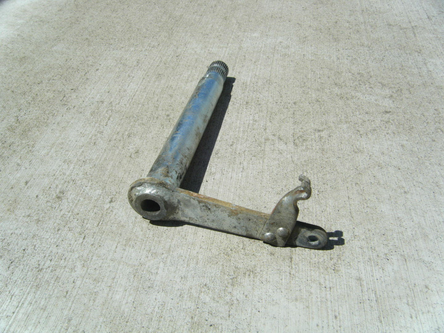

rappaj17, I have an nice brake pivot shaft for sale. $20 delivered in the US. Scram64
