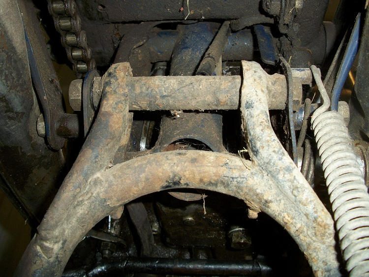

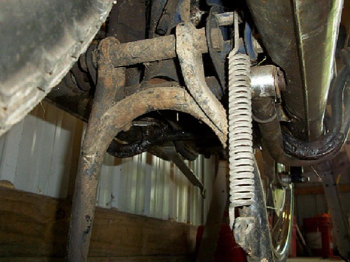

I recently purchase a 65 CB160. The CB160 center stand was removed and replaced with a custom side stand. I am trying to re-install a center stand because I am afraid the bike might tip over with the stand. I have been unable to find any good parts diagrams that show how or where the stand should bolt on. I would appreciate any pictures or install instructions for center stand.

Hope these help .

The most difficult part was putting on the spring. Pennies help a great deal. Bend the spring andinsert pennies between each coil on both sides. This helps stretch the spring.
