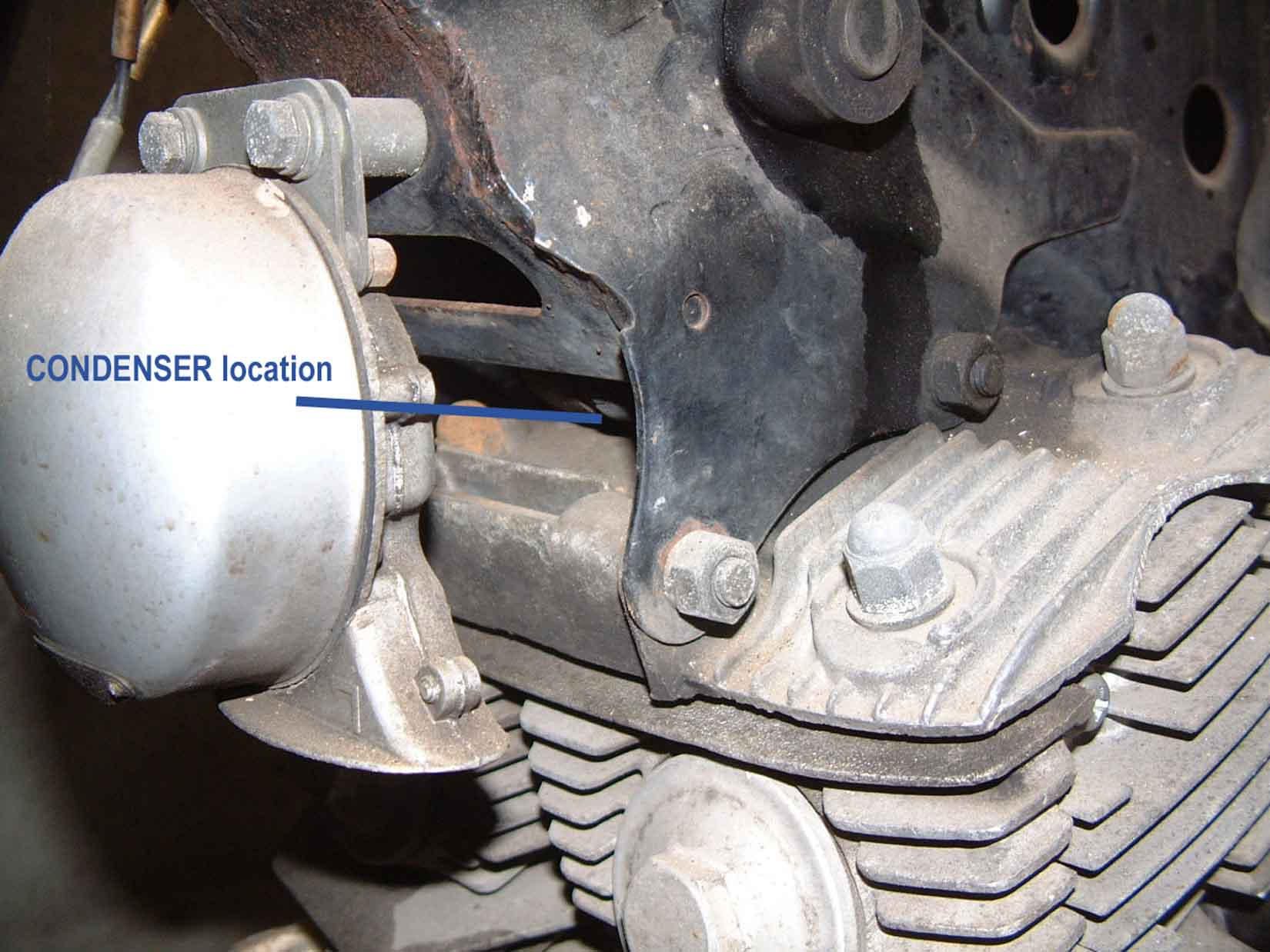

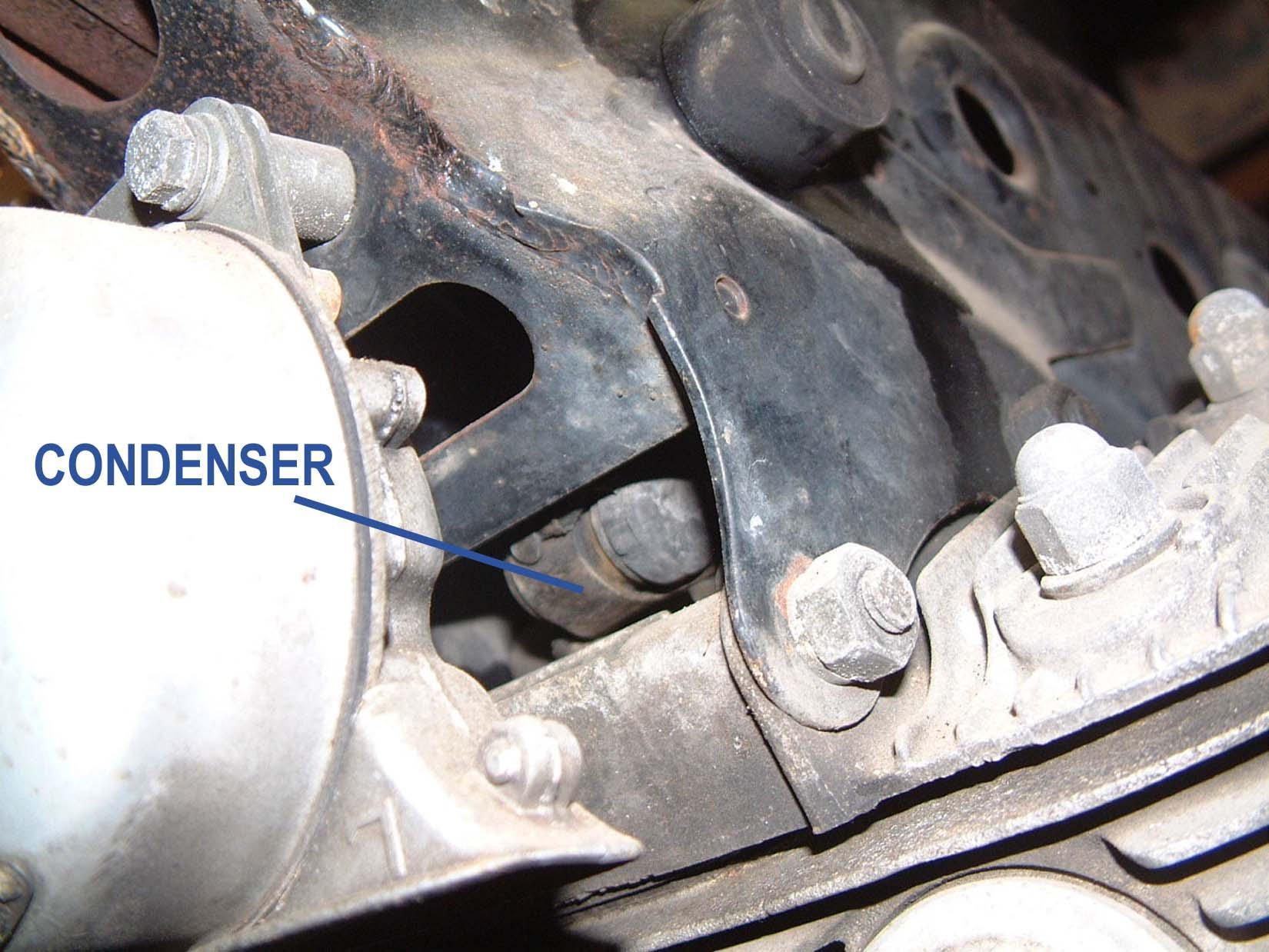

Thganks for the reply . I am not sure the condenser needs to be replaced but as I was changing the points I thought I would change the condenser, until I discovered its location..!! There are two phillips head screws holding the condenser tothe top of the motor. However it is tucked away under the frame just behind the horn..
Clearly it was not meant to be replaced.. Any help would be appreciated.
Thanks JoeC
See photographs
condenser location under frame CA77E Dream on Honda

photo condenser location CA77
Post by joseph22 » Tue Jul 17, 2012 1:07 pm

I would only replace it if I had to. And if I had to, I would probably just leave that one where it sits and mount a new one someplace else!
