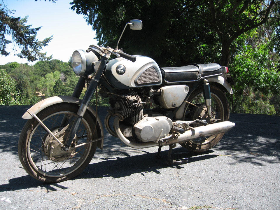

Funny where the road leads... I posted on my local Craigslist looking for parts for the 1966 and a 1961 CB72 with race history in original condition turned up, so the project shifted to the CB72. I forgot to end the ad and a completely disassembled 1963 CB77 with a big box of NOS parts for very little money also turned up.
That aside, I ordered springs for the starter clutch from McMaster Carr and the clutch still doesn't work. The completely apart bike came with an extra engine (or two) and I am taking apart the starter clutch from one of those for the white bike. My intention now is to sell the 1966, make the 1961 roadworthy and then slowly put the 1963 together as nearly perfectly as I can manage.

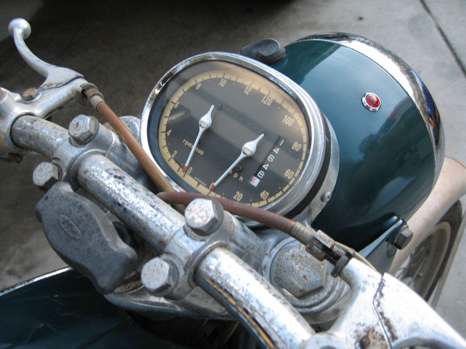

Pictures are of 1961 CB72, the 1585th CB72 made!
I have promised Michael a write up of getting the 61 back on the road so this is a preview of things to come.
