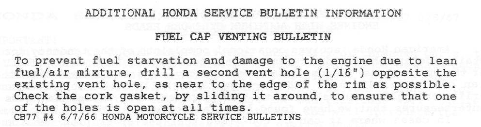

Just to elaborate on Ed's diagnosis: when you rode the bike with an ambient air temp of 60ºF, the 'warmer' head of air in the fuel tank would have presented a degree of pressure to the fuel flow to the float bowls. Now the air is (at least) 15ºF colder, the fuel flow will create a vacuum much sooner in the tank above the fuel level; this will manifest itself as fuel starvation. Honda offered an interim solution for the affected fuel caps:
