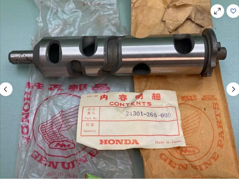

I am guessing this is the culprit can anyone confirm?

I would suggest the bushing (no 17) - most likely:
https://images.cmsnl.com/img/partslists ... 8_c314.gif
Or maybe the forks (no 2):
https://images.cmsnl.com/img/partslists ... 9_f85e.gif
Apart from the drum suggested in the previous post.

You need to be careful when buying drums and forks, because there are two models: one for classic boxes XXXXX - 268 - XXX and the other for rotary boxes XXXXX - 259 - XXX, which comes from the C72/C77.
Some sites may sell parts for rotary boxes without knowing it, as this is a little-known part that was reserved for the Japanese market, but can be found in old stocks.
viewtopic.php?f=22&t=7643370&start=56

This is a chronic problem with these engines. Item 14 in the image https://images.cmsnl.com/img/partslists ... 8_c314.gif has three variants, each with a different offset. If you have the original ones you will see that they are flat with a bit of machining. The others are offset by about 1mm and 2mm.
I fixed this problem by replacing the originals with the maximum offset ones (23943-259-305) on the mainshaft only. I suspect that they wear with use as the 1st to 2nd shifts are the most common and they are often 'hard'. It may also be that a small amount of wear on the mainshaft tapered bushing could also loosen things up. Since they are not very expensive I suggest buying both offsets but only two of each.
I doubt that the drum is a problem but you might look at the forks. If they are bent they can gently be straightened. If the pads are worn down I have heard that building them up with a welder and grinding them flat is possible but I have never seen it done.
