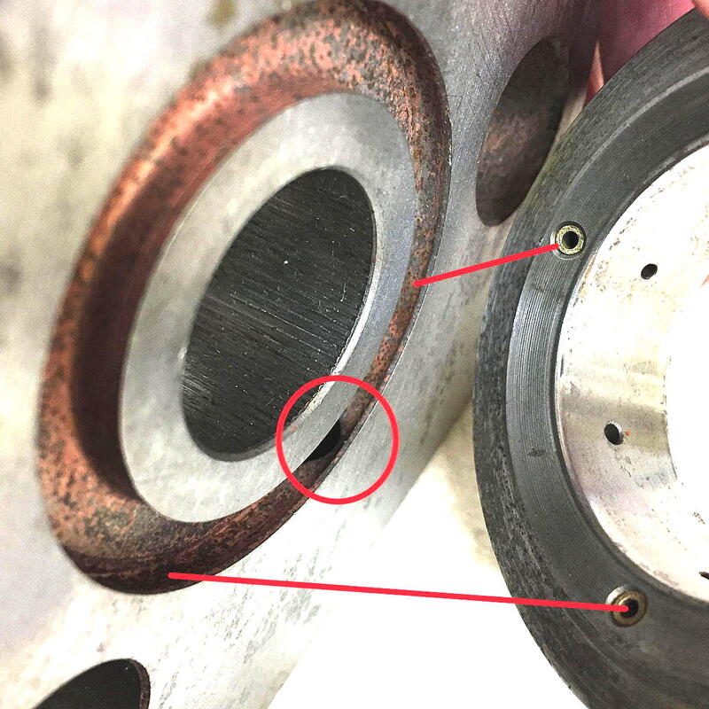

Did you check for dirt/sludge in the centrifuges and big-end pin?
I strip the crank completely and clean everything before reassembly.

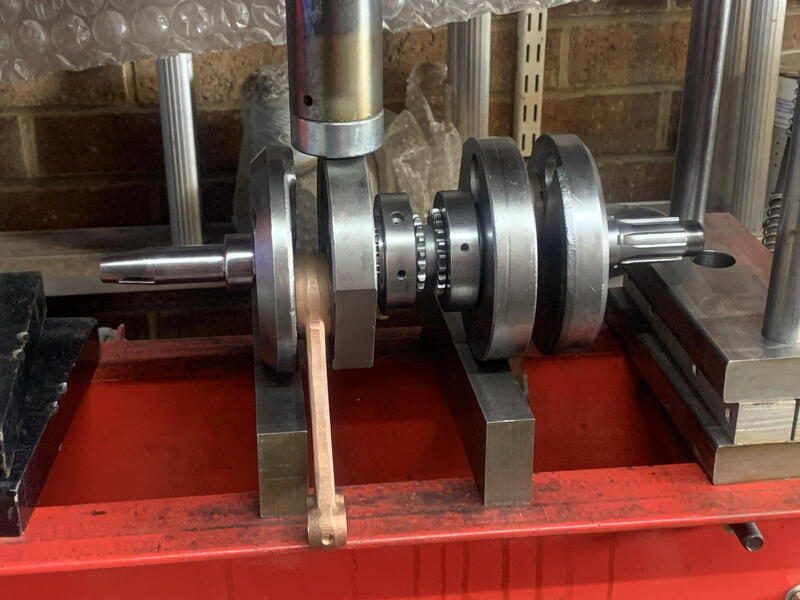

Like you, I true up in the crankcase but use my press rather than a mallet.

No, I had no idea there were sludge traps there. I just pulled off the outer webs, checked the rods and pressed them back on. Unfortunately, my work environment is very primitive (car port), my work bench is the top of a dryer and the press I use is in one of the old B-24 revetments at Dillingham Airfield on the North Shore of Oahu and may be of WWII vintage.
Never thought of using the press to align the wheels, that's brilliant.
