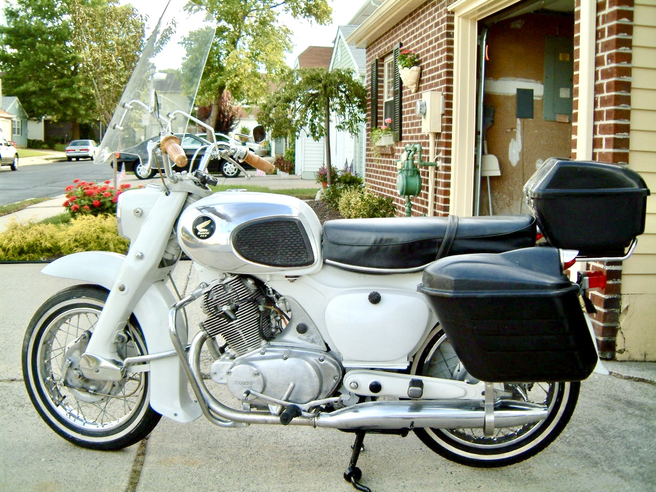

I’ve been restoring this.bike on and off for three years. Attached is a current photo. The only things it needs are new exhaust pipes. Finding originals is next to impossible.
