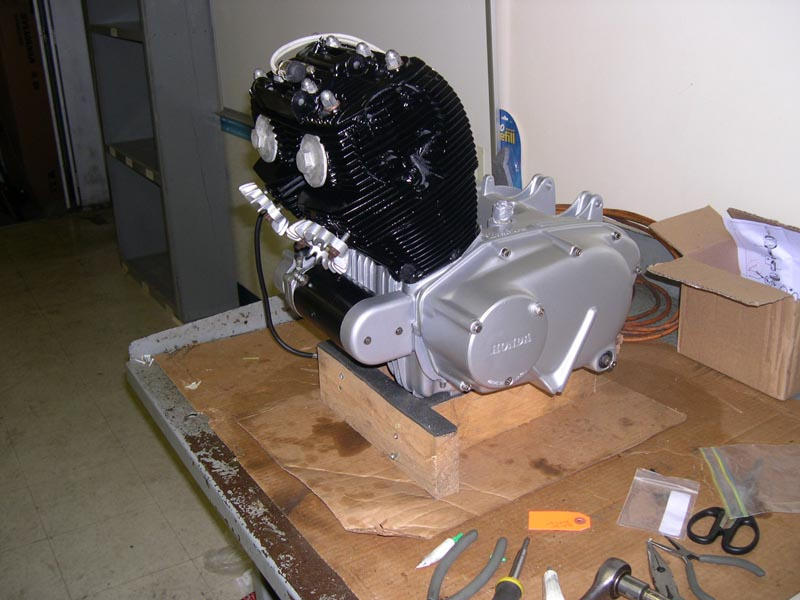

I've been lurking around these boards for a few years now after aquiring the motorcycle itch, and picked up this PA barn stored ca77 2 summers ago. Busy with other projects I hadnt' had a chance to do anything other than aquire some essentials ( a battery and lotsa knowledge) until this past month. started tearing into it the beginning of march, got it fired up and running smoothly in a couple after-work sessions. clutch very frozen, but wasn't overly concerned about that. My initial intent was just to clean it up abit and drive it for the season, but after seeing so many pics of beatiful dreams it seemed a disservice to drive mine around leaving a trail of rust behind. So i tore it down and started cleaning. I wanted to get my restore post up and going so i wont elaborate any further for now, i'll just post a few pics and punch in some more later.

more pics
some more project progress pictures, in no particular order

started out with small wire brush wheel, moved on to scotch-brite and elbow grease. followed these up with 'light' sugar blast to get the stuffs i could reach with the first 2. degreased then followed with acetone scrubdown. lotsa dry air blastin' throughout. praying that the adherence gods are smiling upon me. all paint is duplicolor 500' engine paint w/ceramic. prime coat/2 color coats/1 week cure/2 clear coats.
