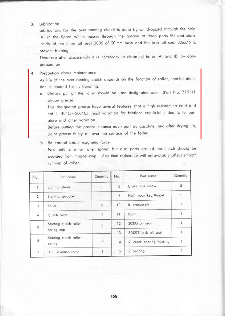

On the clutch ass'y there's a slot, radially-ground, across each of the apertures:
- Apply some Loctite or other thread locker -- a small drop -- to each screw's thread and wind the screws up tight (or to the specified torque of 3.615[!]ft-lb if you're lucky enough to possess an appropriate titchy torque wrench).
Place the rotor on a wooden block (to prevent damage to it or to the surface upon which you're working) on a concrete floor or other suitable solid datum-level surface that will absorb the ensuing impact.
Position the tip of a centrepunch about 1mm from the outer edge of each screw head and in line with the slots in the clutch ring's screw apertures, and pein each screw head twice (once at each edge) with a reasonably heavy hammer; the edges of the screw head will be displaced into each slot.
NB: do not attempt to carry out this procedure using valuable antique furniture as a workbench! This antisocial practice may prove to be the cause of divorce, exclusion from the abode and/or physical deformity inflicted by an irate 'lady of the house'.
Incidentally guys, I found the reason behind my starter clutch's inability to grab: the rollers are worn down. They are described in the Shop Manual as "10.2 X 11.5 roller"; mine have worn down to 9.8, 9.8 & 9.7mm diameter. BTW: they shouldn't be dry, but smeared with silicon grease to prevent this friction-wear. Silicon grease is used because it won't melt away, nor will it become more viscous with colder temperatures.

HONDA left those rollers dry because any sort of slickum will gather dirt/dust and become an abrasive or allow the rollers to slip on the sprocket area. When the engine is running the rollers are
thrown out away from the sprocket so they don't wear when the engine is running. .................lm

On the clutch ass'y there's a slot, radially-ground, across each of the apertures:The rationale behind such engineering is aimed at preventing the screws working loose again.
