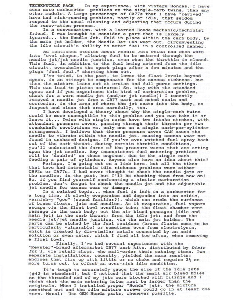

Sounds like you have Bill's Restoration Guide (HNRRG); take a look at his article starting at the bottom of p12 within the TECHKNUCKLE section; there's some really interesting philosophy and otherwised-missed info there for single carb bikes!

Right, logical-look time, stage by stage (nothing is insurmountable here): valve clearances - ☺, ign timing - ☺, valve timing - ? (see following check nº 1).
Really rich? Like, starts with no choke at all and runs ok 'till warmed up, black smoke (unburnt fuel) from exhaust: float level as per Ed's Recipe? Jetting correct? (see following check nº 2).
