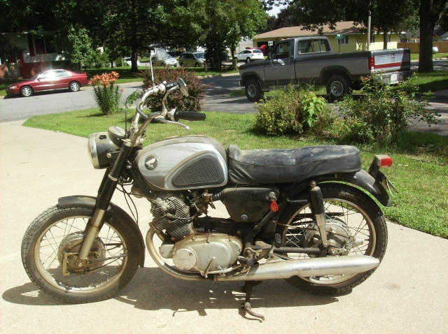

I just found this message board and it looks like a great resource! My brother had this old motorcycle in his garage for years. I rode it a few times many years ago sometime in the 70s or 80s. He had always planned to fix it up, but never did. My son has an interest in motorcycles. We took my 82 Yamaha Seca out of the shed after 10 years of storage and fixed this up. Since my son had an interest in fixing up motorcycles, he gave my son this 66 CB77.
We are in the process of fixing things and plan to paint it in the original black and silver colors. I know it used to run, but at this point we have not tried to start it. We have replaced fuel lines, throttle cable, plugs, and changed the oil. The tank and fenders side covers, chain guard, license plate bracket are all ready for paint.
The kick starter was very loose, so we took this apart and found the bushing had a piece broken out of it. We replaced this. The starter also seems to not work. I am working on this now.
I posted a few pictures of when we first brought it home, and another as it looks now.

Update: We fired it up tonight and it sounds great!
I have been working on it a little at a time. It seems ever step forward, we get set back from something else, but hey, this is fun. I found the starter had short from ground to the stater windings. I picked a working used starter motor up on Ebay, and it works great. We put a little water in the old battery and charged it, and it works. We are using this until we are ready to ride. The starter switch had a short, a bit of hot glue for an insulator solved this.
We didn't have spark on one side. I found one of the mounting screws on the points didn't seem to be the right size, and the points were out of adjustment and not opening. I put in a new screw, cleaned and gapped the points. I got a strong spark on both plugs.
On our first attempt to start it, one side fired and I could get it to run. The side not firing didn't seem to be getting fuel. I took the carb apart and cleaned it up. It wasn't bad, and I didn't find anything that looked like it was a problem. I did remove the screens in the banjo joints (I found this in another post). They were plugged and had junk inside them.
I rebuilt the air filters using instructions I found on the message boards. They turned out great. I posted a picture on that post.
Tonight, we put everything back together and after a little cranking, it fired up. It sounds great! It could use some tuning up, but for now, I just wanted to make sure we have a working bike before we go much further.
