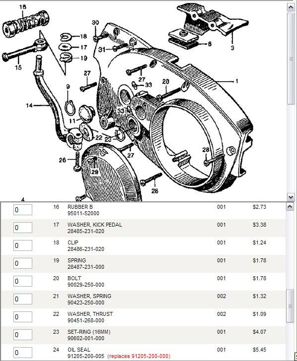

The kick start lever is still a little bit loose, not as bad as it was. I was looking at some parts someplace, maybe E-bay, and saw a replacement kick start. It came with this coiled washer that looked kind of like a heavy spring. I didn't see anything like this when I took mine apart. Is there supposed to be something like this on the shaft to keep the kick starter tight?

The kick starter spring works well, this isn't the spring I was talking about. What I mean my loose is it has a lot of play. The spring type washer looks like it may add a bit of tension to reduce the play.
I don't see it shown in the parts catalog. Here is a picture of it:

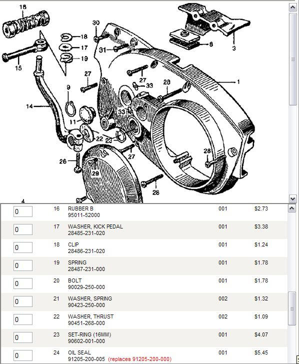

That spring is for the pedal -- see attached screenshot, item 19.
On mine, the circlip (item 23) was missing, allowing the lever to flop about a bit in the bushing. I fitted a 16mm stainless circlip -- floppiness solved. I may get another, slightly larger, for 'those' moments....... Can't afford Viagra!
