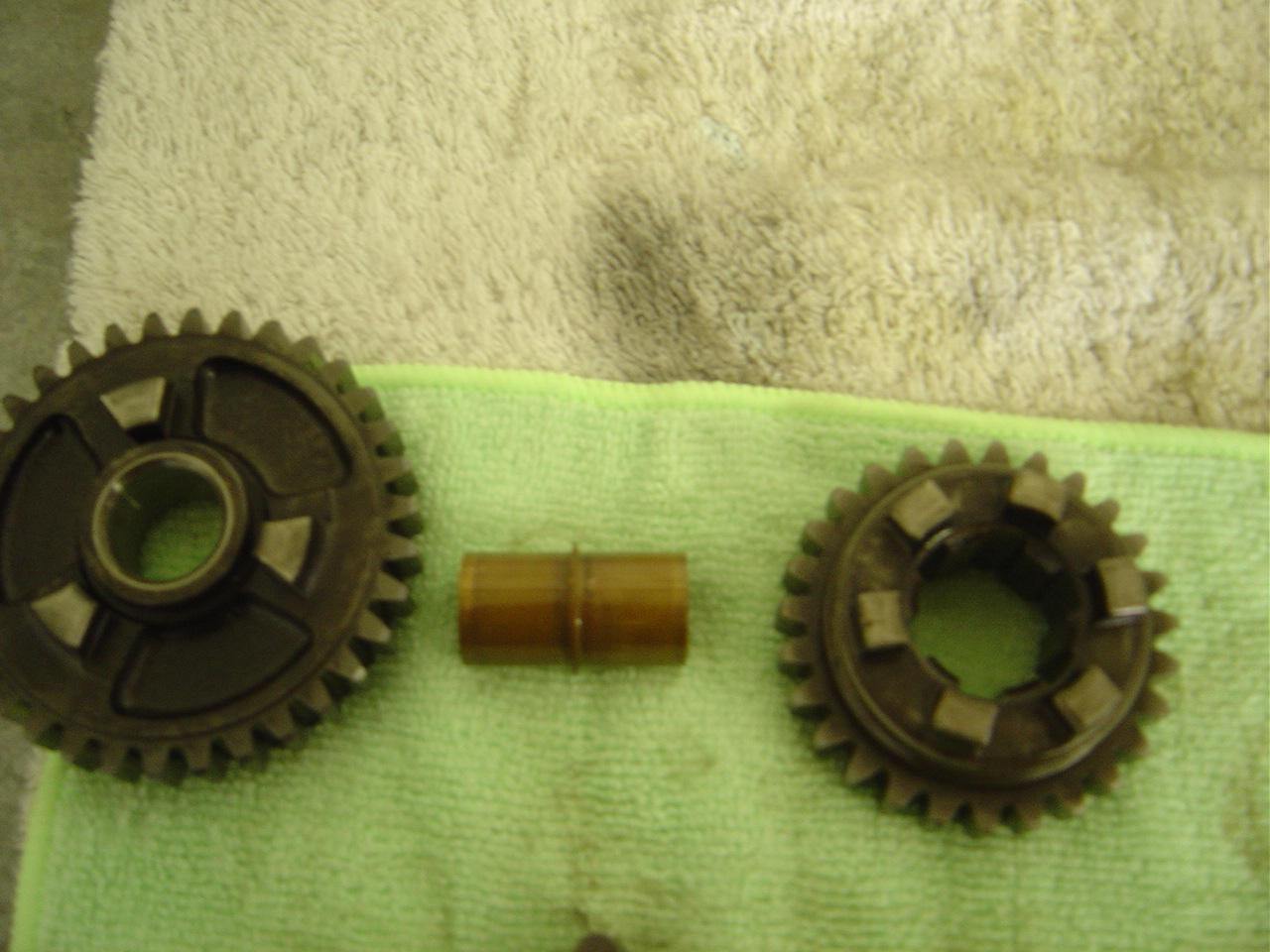

I pulled the K/S shaft gears today. No great wear that I can see. Rollers look fine as well as the shaft. The 14 mm bushing still has good oil grooves an no noticeable play. Even the pawl looks good. BTW the bushing goes back with the oil hole opposite the pawl, correct? I don't think I reversed it but want to be sure. I should be picking up my head and cylinders tomorrow and a NOS Honda head gasket hopefully will arrive today. Tonight I celebrate 23 years of marriage this time around, but the rest of the weekend should be free and guess what I am going to be doing??? The pay back is a complete remodel of the master bathroom for the Better Half. That is going to run more than a CL77 refurbish but maybe that's why it has lasted 23 years.
