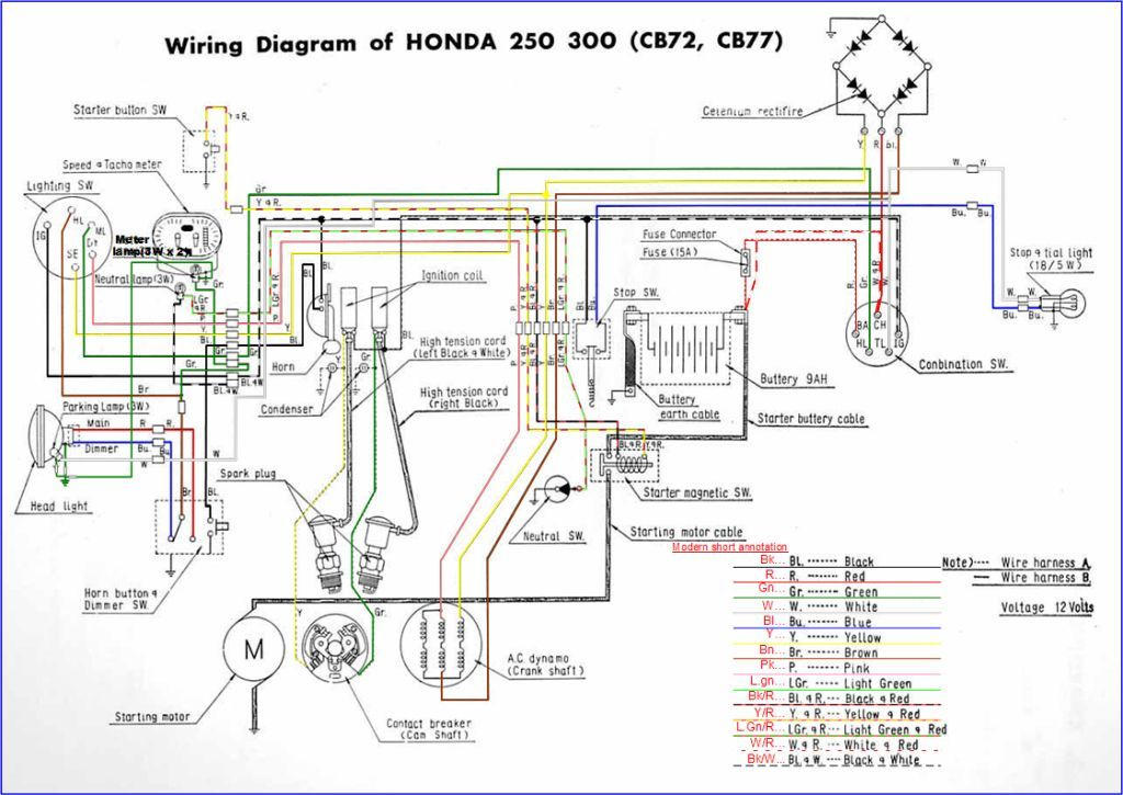

The pink carries AC from additional coils within the dynamo (alternator) and adds these coils to the yellow wire which also carries AC. This increases the voltage and available current at the rectifier to support the demand placed upon the system when the lights are switched on.
The white wire, according to the diagram (my CB's not easily accessible just now) comes from the ignition (combination) switch.

Sorry deez, I'm moving drum and I'm relying on free public wifi. Is this the brown from the light switch that goes to the 'bar dimmer switch and connects to the green of the meter lamp (according the the wiring diag)?
I suspect that, without a battery, the lights are sinking the available current which is, in turn causing the voltage to collapse. Does the headlight work if you connect the brown once the motor is running?
I'm not certain that the diagram is totally correct as, without my own bike to hand, I can't work out some of the switching paths.
EDITED: wiring diagram replaced with colour version
EDITED AGAIN: Diagram corrected once more.

thanks a ton for all the help you guys! and sorry for not responding e3steve i got fustrated, gave up and tore the whole bike apart to take to powdercoaters. so i finally got it and you guys were right. i hooked the pink and yellow together • the black with white collar to the green • then the brown from the hi-lo handlebar switch to one state of a radio shack switch and the other state to the black with white collar. works like a charm. e3steve you were right about it drawing too much power and the switch was the only way around it. funny thing is then i hooked up the tail light then the bike wouldnt stay running! the 35w halogen and the tail light was too much for it so i added an led bulb on the tail and everything is all good.
