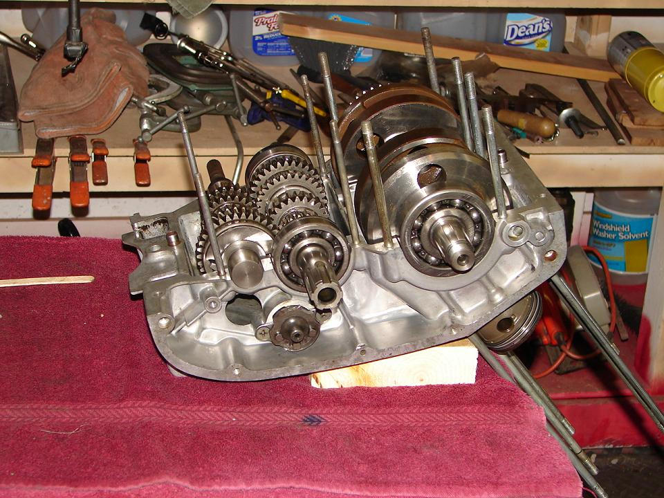

crankcase assembly
Sent a PM to caldreamin, but thought I'd elaborate. The comment about crankcase assembly came after reading a casual comment in one of LM's replies to someone. In it he mentioned putting assembling the crankcase components with the top half of the crankcase upside down on the bench, and then placing the bottom half on the assembly and buttoning it up. It was an aha moment. Doing it this way means you can align the shifter forks and make sure everything is in place and works. Then you put the bottom half of the crankcase in place and bolt every thing down after sealing properly.
Mike
