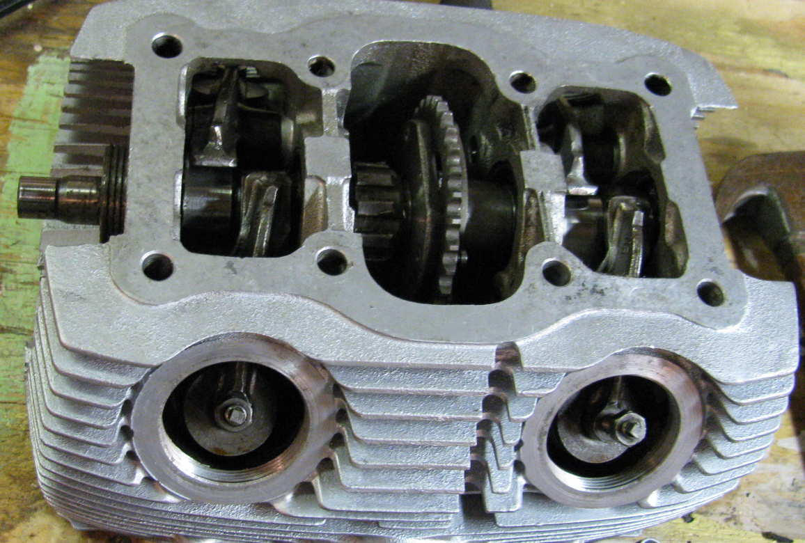

young4vr,
lm said points cam on right side, meaning right side of bike when you are seated on it in the riding position. You were saying right side when facing the exhaust, meaning you are looking to the rear of the bike. You may have assembled it correctly! --Randall

Ok, confusion has really set in
I will take a picture tonight and post it. I don't want to take it back out because it is not the easiest thing to put back together. Picture will be up tonight or tomorrow.

picture included
Here is the picture, looking from the carb side, the points is on the left.
Re: picture included
Bad news! It's backwards for sure. .....................lm
